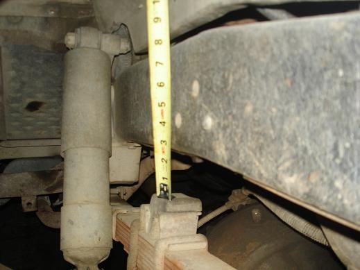

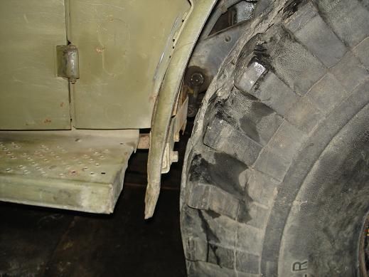

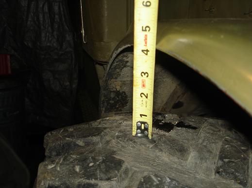

whats the max you can do on a stock suspension M37 with no rubbing?

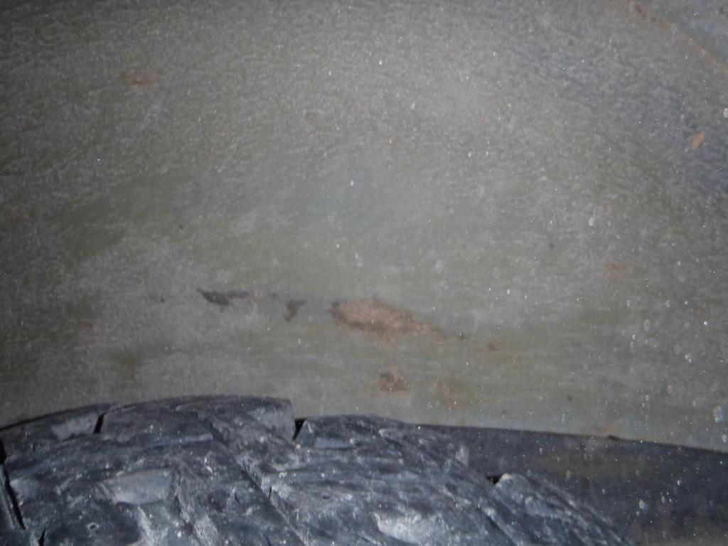

a stock setup with 900x16s will rub on the box if you get her twisted enoughTuko wrote:whats the max you can do on a stock suspension M37 with no rubbing?
