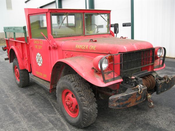

I noticed yesterday For whatever reason my ignition filter is mounted to the firewall but nothing going in or out of it any idea why this might be?
51 Dodge M37 W/W 4BT/NV4500
My G741 Registry Entry
WarrenD
Posts: 498
Location: CT
Re: New member hello and some questions!
Post by WarrenD »
Ignition filter or rectifier? The originals had generator/rectifiers but some folks have had theirs converted to alternators which don't need the rectifier. As you're finding, these trucks have been subject to Bubba mods for many years.
Post by Tuko »
warren its this guy thats circled, its there just no wires. This pic isnt mine its one I found on google:
