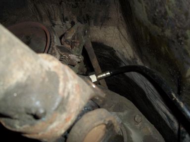

Re: Speedometer not working
Jerry, here are a couple of pix:
- speedo cable 2.JPG (16.25 KiB) Viewed 2665 times
Sorry, it only allowed one photo-hope that helps,
Thanks Gary for the pic. It matches mine and IS a tight fit.
I pulled the speedo drive unit off of the transfer case. A 7/8" deep well works great.
The inner shaft has a small gear and "nub" at the end that seats into the inside of the transfer case.
The "nub" is clearly broken off and the gear is in very poor shape.
