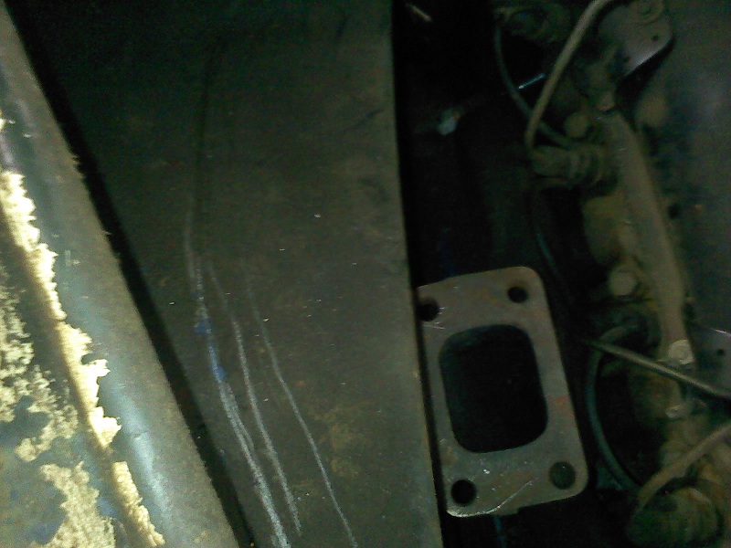

After I got the motor in which is sitting good in the frame. Only problem would be having to change the glow plugs would require removal of the inner fender and tire to get to them. Otherwise no clearince issues.

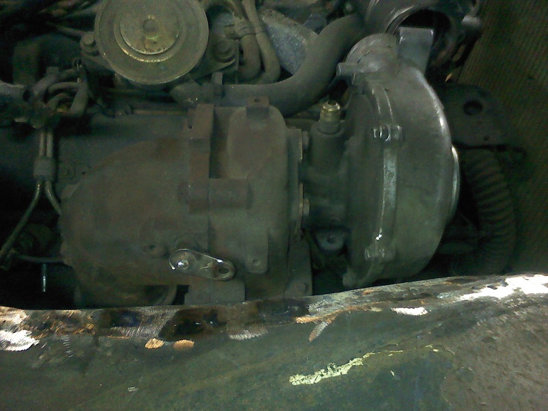

I then put the front fenders on and found a little clearance issue with the turbo.

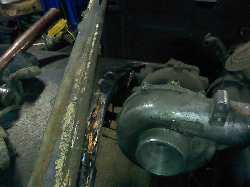

So I got out the welder and mad a slight modification to the fender. Now it fits.
I have to modify the inner fender/splash shield now but I knew that going into this project that it would need some modification. If I could keep from running out of welding wire maybe I'll get all the modifications and welding done before the end of summer and I can get this thing to the blasters.... keep your fingers crossed.
