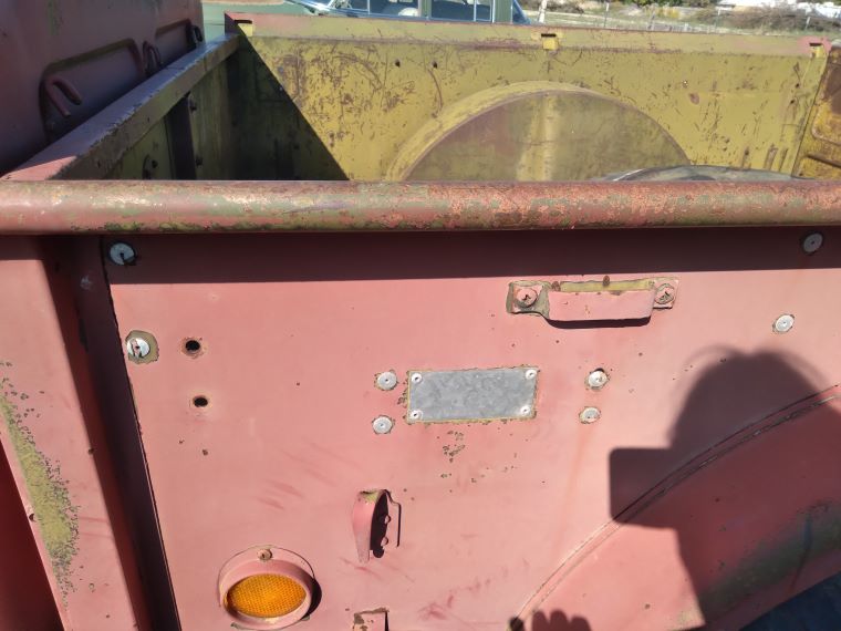

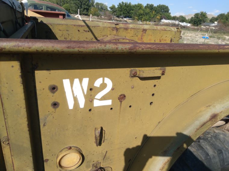

Well I went out and looked at the bed side of both trucks and found this.
So I'm thinking there is some kind of plate missing on the green truck that is still there on the red one. The plate is illegible so I have no idea what it was for.

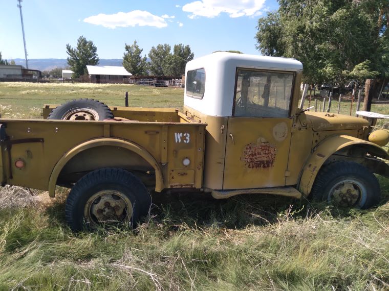

As long as I'm posting questions and pics, has anyone seen a top like this one? Is it military issue, or what?

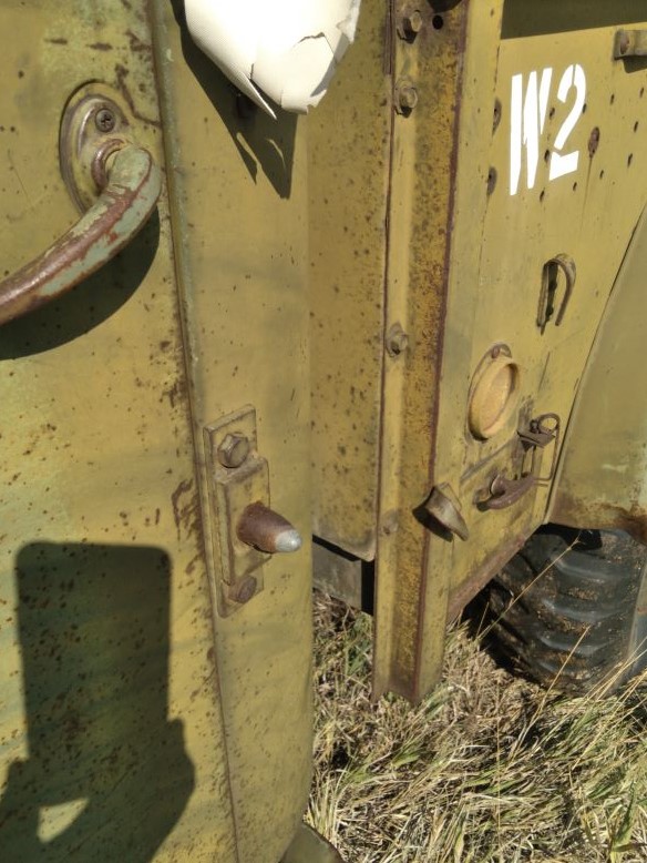

And what is this bolt on, cone shaped attachment on the rear of the cab behind the door, driver side? It has a notch underneath so seems to be something that would have something slide on and have a spring loaded (?) tooth to keep whatever it was attached.

That riveted plate I've never seen-perhaps it is just a patch panel?
The nub at the back of your driver's door is the latch pin for the door-mounted spare tire-used on the M37 B1 series trucks.
That is also some kind of aftermarket top-The M37 hard tops are very hard to find. Vintage Power Wagons offers a glass top at around $1K. Some folks adapt the WWII CCKW hard top that allegedly fits pretty well.

Whoa... a spare tire carrier on the driver door? And from the pics I've found it looks pretty flimsy for the weight. But the pin is stout so maybe the carrier is tronger than it looks.
The plate on the bedside of the red truck is definitely not a patch. It is the same kind of plate that there are several of in the cab.
I finally got the third truck home. The fibreglass top is kind of nice. It turns out that the truck is a '53 and the frame number is eight digits. Unlike the other two trucks the number on the glovbox tag hasn't any relationship to the vin on the frame.

The door mount spare is a beautiful piece of engineering, and is very handy.
A bed-mounted spare is never needed until the bed is full up with heavy items.
Anyone saying the door spare is a pain never read my info on how it is SUPPOSED to work.
