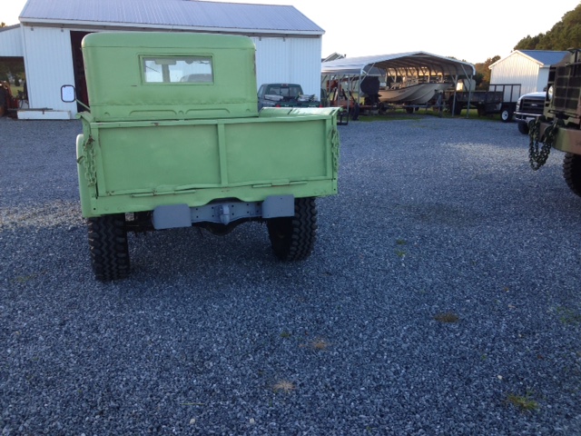

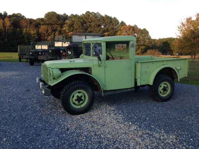

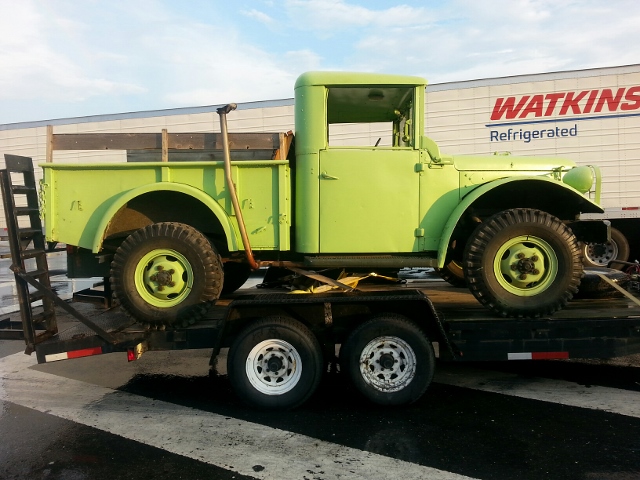

I'm pretty sure its original. It has rear square slider and fits the truck really well. Doesn't look like somebody homemade it, of modified it from something else to fit. I'll attach a couple pictures, see if you think original. Will try to get it off this week, and then see how bad. I would like to keep original, as they seem to be somewhat rare. Its been a bear getting off. The worse spot being where its bolted to windshield frame. As you know almost impossible to get in there with anything to cut bolts off. Only 2 outside ones left to get off The whole metal mounting strip where attaches to windshield is almost gone. And just know found out the out side of the front edge is paper thin as well. That ugly green paint did a good job of holding it all together. The picture on the trailer was when we brought it home from New York. Ill let you know if decide to part with it. I would rather see fixed than in scrap metal dumpster.

If I ended up with it, I would restore it (I would replace the the insulation with something more modern and less hydrophillic).
I probably wouldn't install it, but I would really like to have one for the "accessories accumulation" I've been working on for decades.

Don't scrap it for sure. I have worse and they are repairable without going overboard. The inside metal liner and fibreglass insulation can be replaced by a closed cell foam and modern headliner. Anyone looking for a top would be happy with that one as they are not common south of the 49th. Up my way, all M37CDNs had hardtops but age and rust are taking their toll on them. The one off my parts truck went up the road to a friend doing a restomod and with a some work it looks like new. We had to use the recip saw to get it off the truck as it had the same issues as yours. He just replaced the mounting strip as part of the reburbishment, long with a few other rust issues. Depending where you are will determine the values 'as is' but I can guarantee that you will get fair value for it and the buyer will be prepared to travel to get it.
