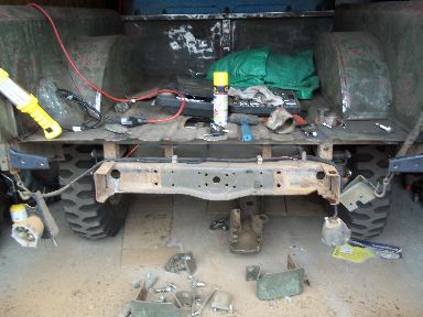

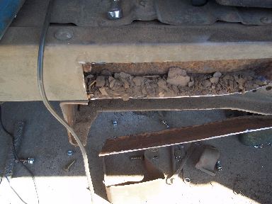

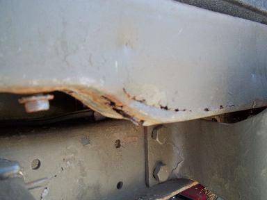

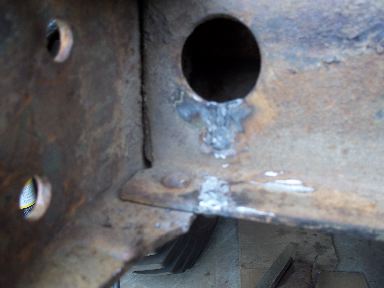

Well I finished my fording exhaust mount repair, then have moved to the end of my bed. My intention was to use filler panels to replace the crusty bed rear bottom. As the pictures will attest, that's not going to happen, and I'm making arrangements with John Bizal for an entire rear panel....

Gary,
Who put all of that stuff inside of there? You know that's why it rusted out.

The deeper you dig, the more you find. Paint it with a broom and you're done!

Hey that's the good side! I can only figure that the bed was stored so everything flowed to the back when it rained or snowed with the trash accumulating and cancering out the internals. Got my money order off to John today.

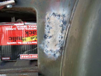

Anyway, with that section on hold I moved over to the driver's side hole by the cargo box door. It was the size of a quarter until I started chipping-ended up with a 1 inch by 3 and 1/2 inch patch panel to spot-weld into place. I'll add those pictures later this week.

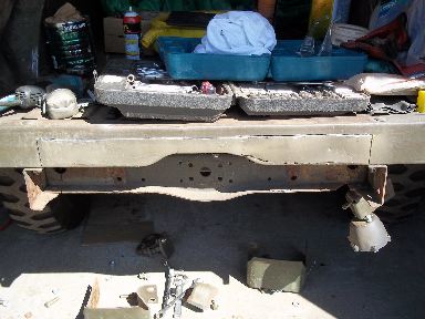

More pictures:
- welded up crossmember cuts.JPG (15.37 KiB) Viewed 3278 times
- patch in bed side 2.JPG (18.46 KiB) Viewed 3278 times
- bed rear totally removed.JPG (25.49 KiB) Viewed 3278 times

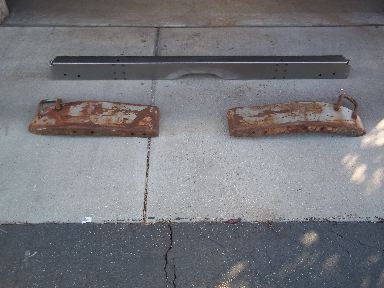

Gary. At least your side "L" brackets appear to be in good shape. Mine were totally shot and I had to fabricate new ones.

The left is worse than the right, but nothing like the old ones in my old bed (that I replaced with THIS one-tell you how bad the old one was....)

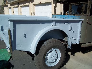

Today I put a solid 4 hours on the truck, specifically on the bed end-primered it, let it dry, then installed it. Learned a few tricks along the way, too. By leaving the right-side bracket in place, removing the left bracket, setting it loosely in the left end of the panel, then loosening up the front bed mounting bolts (haven't installed the middle ones yet), then jacked up the left end of the bed. This allowed me slide the panel onto the right side, (clearing the end of the frame), flex out the left side panel just enough to coax the left bed end inside and up, into its proper place, then bolted it up, except the 6 phillips-head 5/16 bolts that attached the floor to the end panel. Even my Fastenal store doesn't have replacements so if anybody has spares or knows a source, please let me know. I'll post pictures in a day or two.

With more pictures--Re: Paint prep and more drama...
Some photos....
- fresh bed primer 2.JPG (25.24 KiB) Viewed 3100 times
- end panel in place.JPG (22 KiB) Viewed 3100 times
- end panel & bumperettes.JPG (21.65 KiB) Viewed 3100 times
