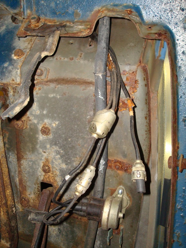

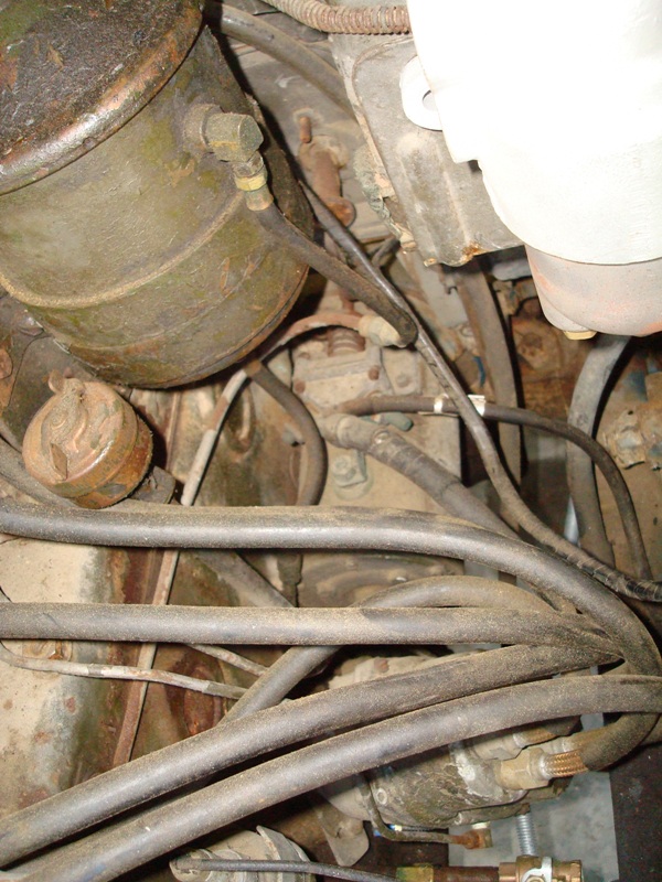

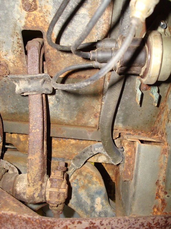

Here are some pictures of the current routing on Ol' Blue...
Back of cable assembly showing short ground lead to running board bracket - as Charles mentions there is also a bushing where the wires come through the hole in the cab tub:
Cable routing by the dimmer switch - there is a rubber clamp missing in this location:
Attachment to the starter:
The new assembly has a part number of 8707574 and has ~ 12" of ground lead and ~60" of positive lead. The one I have has a date code of 1970 on it - Charles do you have any tips for separating the pins from the plug assembly for replacing the cable?
