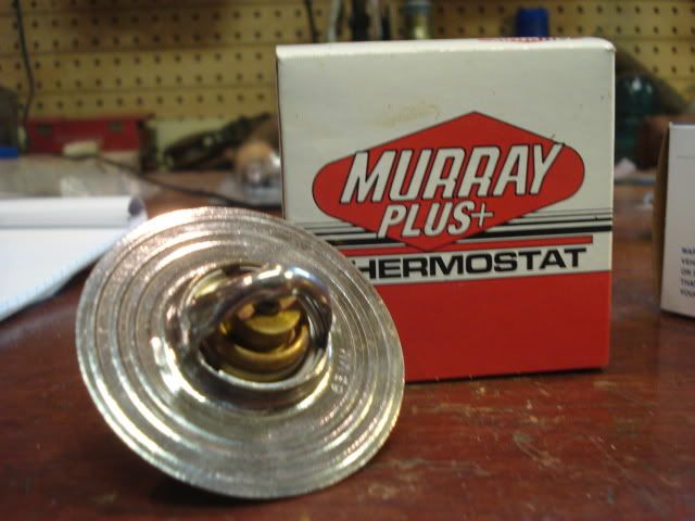

FIrst get the correct themostat. I finallly got the right thing after talking with Charles T. about theremostats.
This is the correct thermostat from NAPA #55 is 160 and #155 is 180. They had a 160 on the shelf so I bought it. I ordered 2 more at 180 to have on my shelf.
So here for comparrison is the style we see most often and is wrong for the M37.

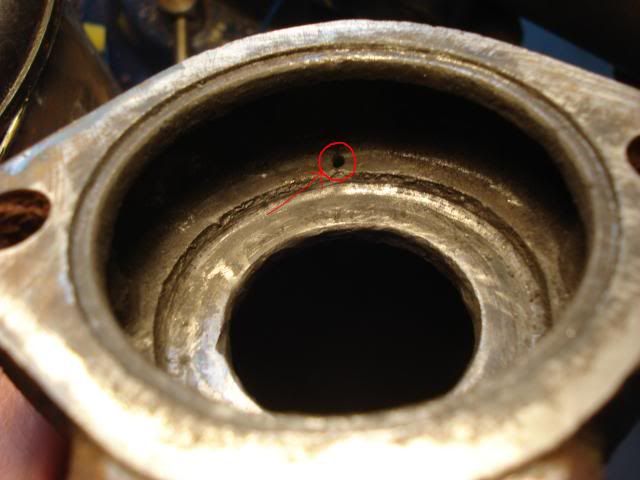

Mine was equipped with the wrong style. As I was cleaning up the housing I found this little cast in hole. How cool is that? Dodge made a little relief hole so air can escape from the system and a little water can get through also. However with the wrong thermostat this hole in not functional.
I tried to hi light it with a red circle.
So stay tuned and when I get back from work and get rested probably Sunday I will contiue with the post.
