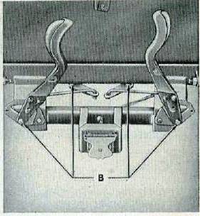

k8icu, here is a photo from the 1952 dated TM showing the receptacle box between the brake handles. Also, Bizal has a trailer on his site that has the setup also. Check out the link in my first post.
Thanks again.
Extract from TM 9-874A, M101 Trailer, dated 1952 showing intervehicular cable receptacle.
M101 Trailer Harness Receptacle.jpg (19.88 KiB) Viewed 1009 times

Re: M101 Harness Change
As I said I had never seen one, but now I have. That must have been the thing to do in the 50s with the 1/4 and 3/4 ton and just speculating but probably the late 50s and early 60s was when the change to connected cable was made because the late M100s have the single cable and of course the M416 which replaced the M100 as the 1/4 ton is single connected cable. The change was probably made because to many GIs were loosing the connecting cable or they got stollen by othe GIs who lost theirs and thus made the lights inoperable on the trailer...so the army went to the attached cable so that it couldn't get lost.
Even the 1993 manual shows all M101's and M116's getting the stand alone cable. The cable attached to the terminal strip on the draw bar is introduced at the M101A1 and M116A1. Since the original M101's were produced in the 50's by the time they were surplussed out in the late 80's and on, most stand alone cables had been replaced with the newer style as supplies of the old cable were depleted.
The 1/4 ton M100 production was heavy in 1951 thru 53 but then sporadic until 58. It is suspected the switch in cables for the M100 occurred around 1953/54 when the storage box was discontinued.
