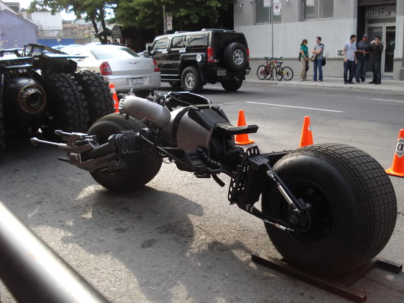

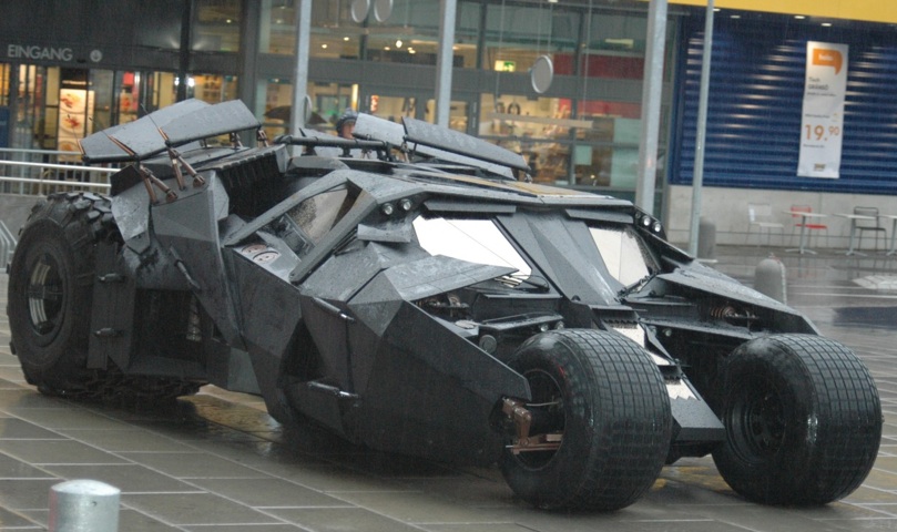

Josh, maybe you could try and build something like these :shock: :P :
Stu
MVT UK
SMVG Scotland
