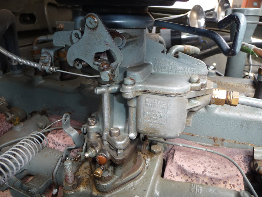

Hi all
Can anyone identify the model of Carter carburettor I have here?
I would like to get a service kit for it if possible.

Re: Carb identity required
It looks like a Carter DTA-1.
Looks like an E7T2 to me (I'll have to check my journal because I scrapped it when I got my ETW1).

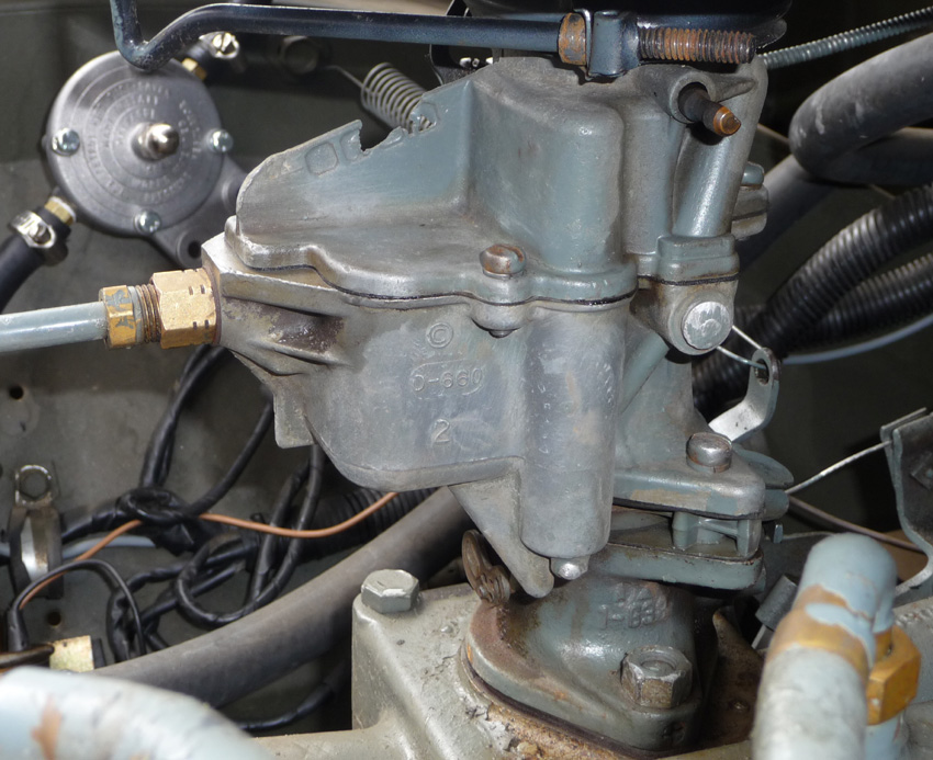

Interesting! The top was made in St. Louis and the bowl was made in Detroit. I never noticed anything like that on a carb before. I just assumed that both castings would be made in the same factory. Obviously, I made that "ass/u/me" mistake again!

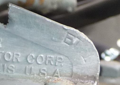

I can make out what looks like ET and a 1.
I wonder if the top half doesnt belong to the bottom half ??
It certainly does look like the DTA-1 Rick, thanks for the link.rickv100 wrote:It looks like a Carter DTA-1.
just went out and looked at my truck. It looks identical to the E7T2 on my 230 but it seems carter made many carbs that look fairly similar.
98taco3 wrote:just went out and looked at my truck. It looks identical to the E7T2 on my 230 but it seems carter made many carbs that look fairly similar.
Your right, I just looked here
http://t137.com/ClintDixon/E7T2.htm
and that does look just like it.
Darn it, why did Carter make so many variants of a similar product !!!
OK, another question for everyone, which carburettor is the best one to use in your opinion ?
Look closer. The entire carb was built by Carter in St Louis for the Chrysler company in Detroit.Interesting! The top was made in St. Louis and the bowl was made in Detroit.
Well spotted !!
You seem to be right, Cuz. My eyes weren't doing their job properly when I "saw" what I "saw." Either that or the "computer" in my brain failed to properly analyze the data before delivering a false report. Now, what was that I said before about ASS/U/ME?"

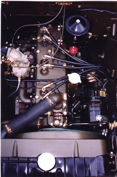

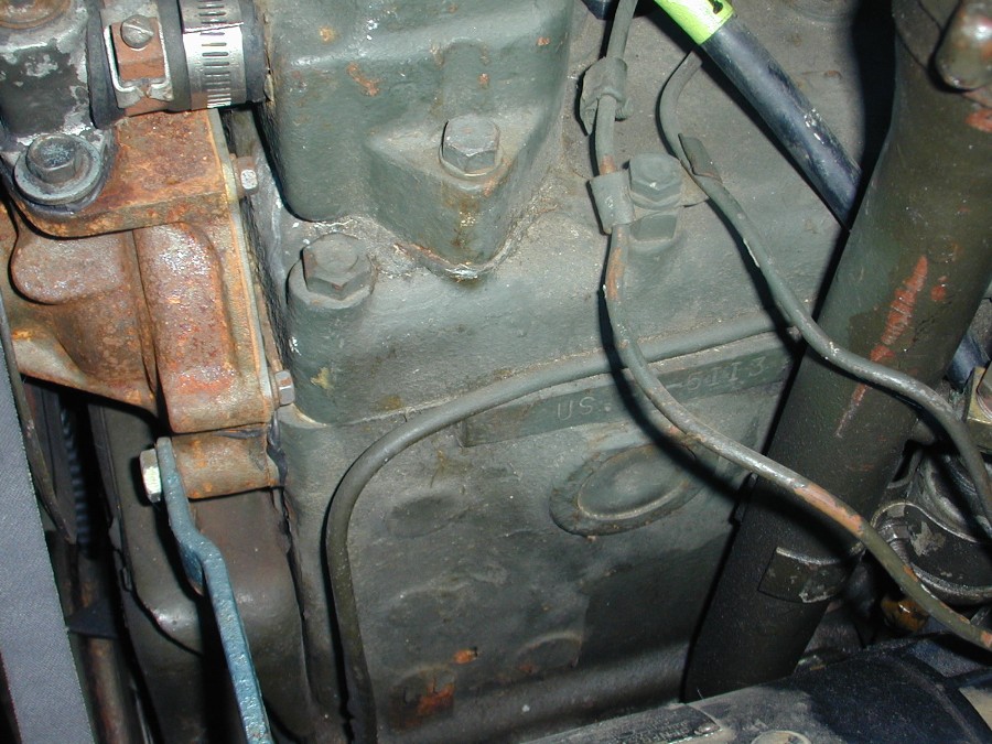

Here are a few examples of what is under the hood.

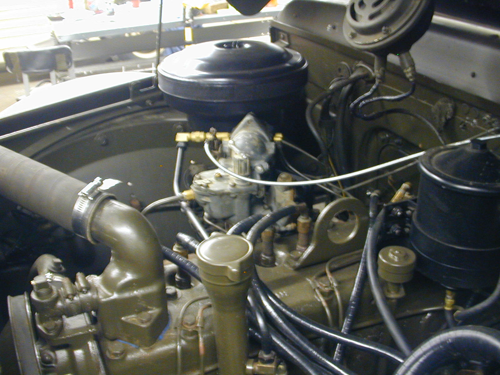

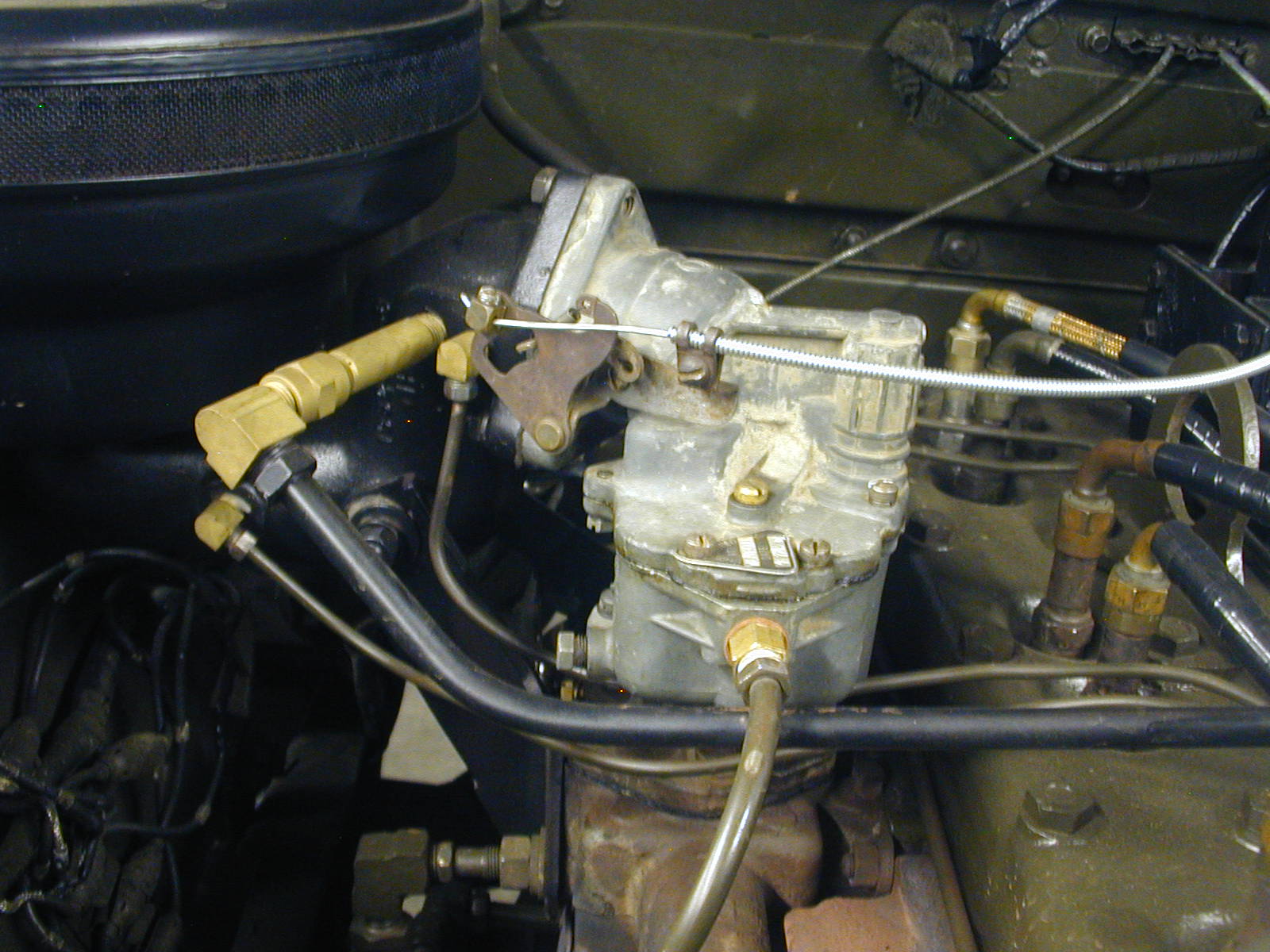

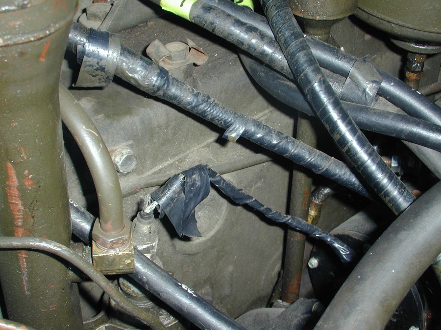

Here are a few more.
Not the two tubes hidden behind the intake just ahead of #5 spark plug.
This is MThrax's engine.

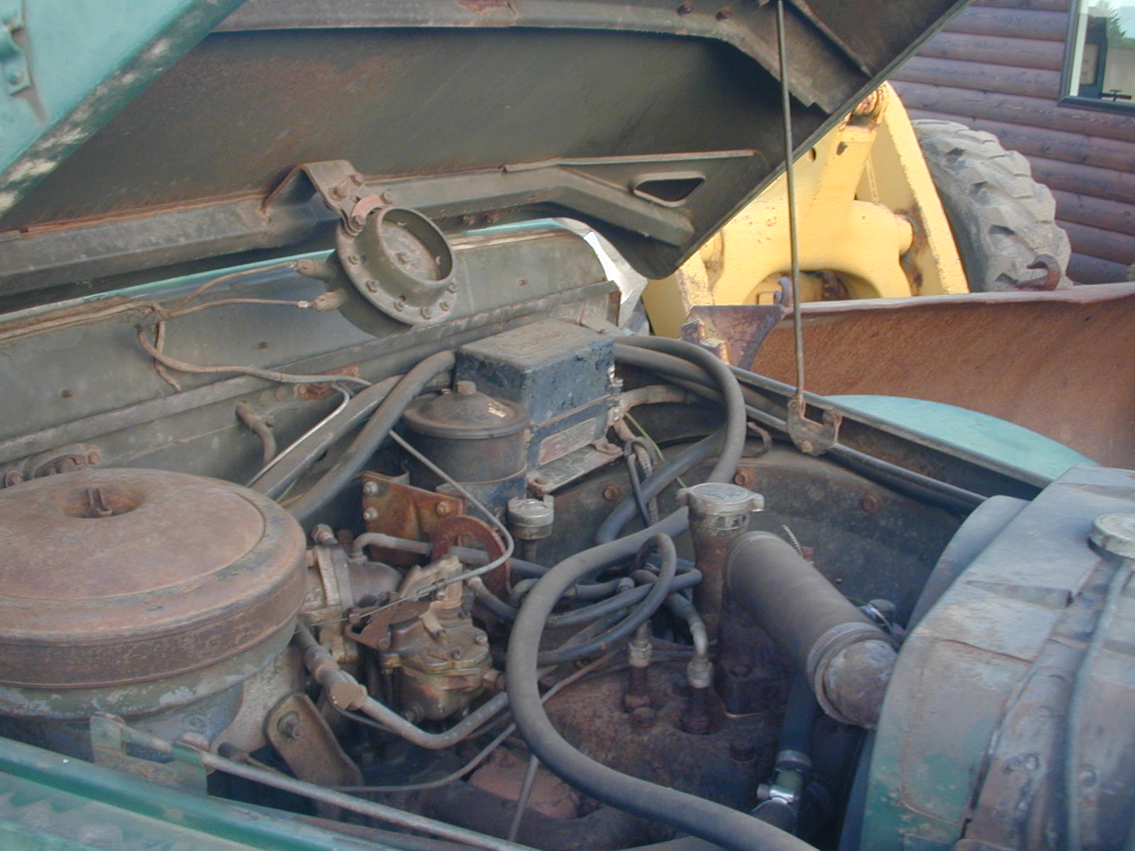

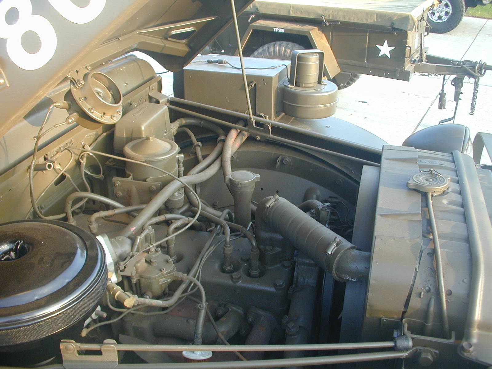

Here's a few of my current ride's un-restored engine.
The two distributor vent tubes
Notice the two missing tubes.
