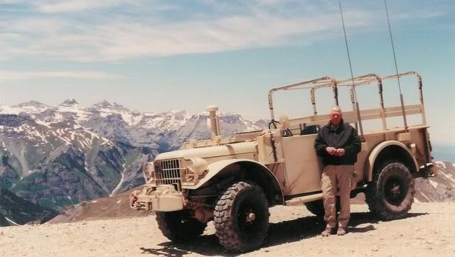

The photo above is about 10 years old. I ran into John Gentry in Ouray, CO where he had this truck and I took a lot of photos of it. There are a lot of innovations on the truck, the most notable to me is the NV4500 transmission which inspired me to put one in my M37. I believe he told me that they had made 3 or 4 of these trucks for desert operations. That is why it has AC and the snorkel intake.
Frank

One thing I thought was interesting was the 5 degrees of caster to improve hi way handling. Would that really make a huge difference ?
Frank can you post a couple of more pictures? I would like to see under the hood and the interior mods. I just found the sight and had no idea that it is 10 years old.

My truck has the stock transfer case, NP200 I believe, but I'm sure you have a different number for it, LOL. John's truck was very well done and gave me inspiration for my truck. At the time, which I believe was 1999 in Ouray I didn't even have an M37 but the features on the truck caught my eye.
Frank
