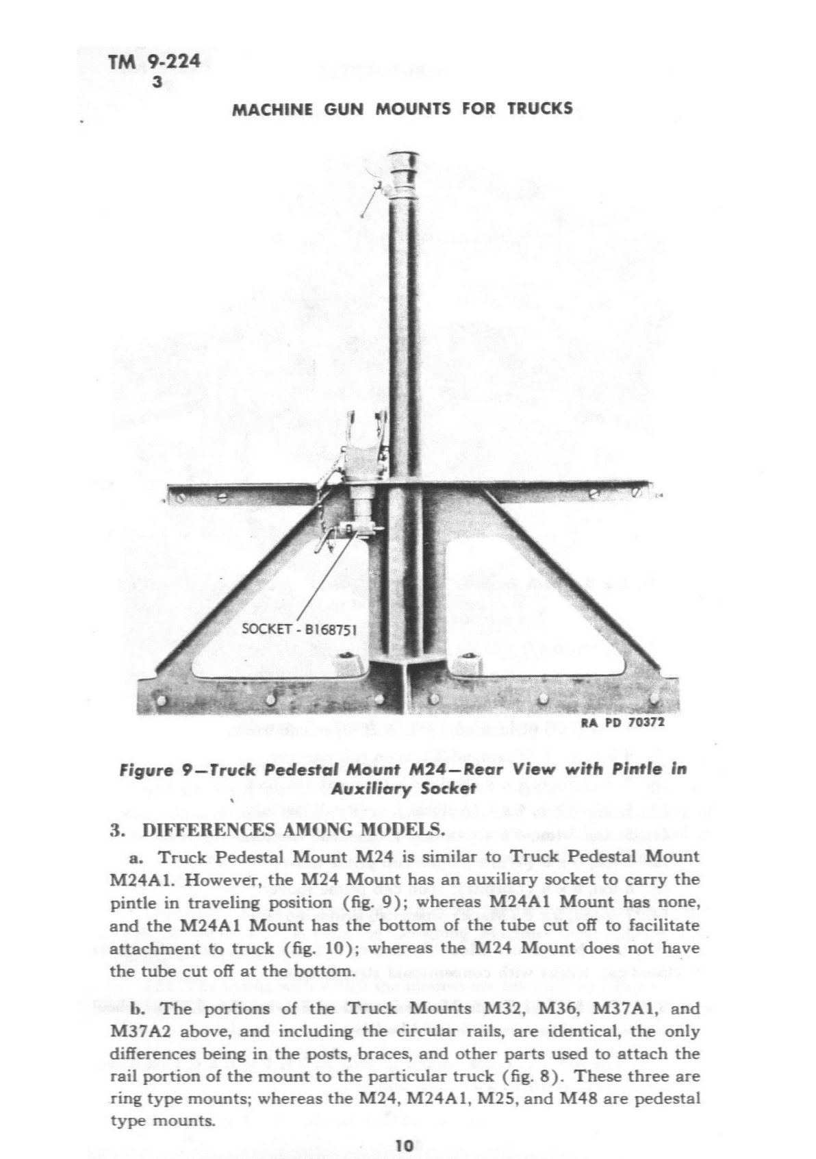

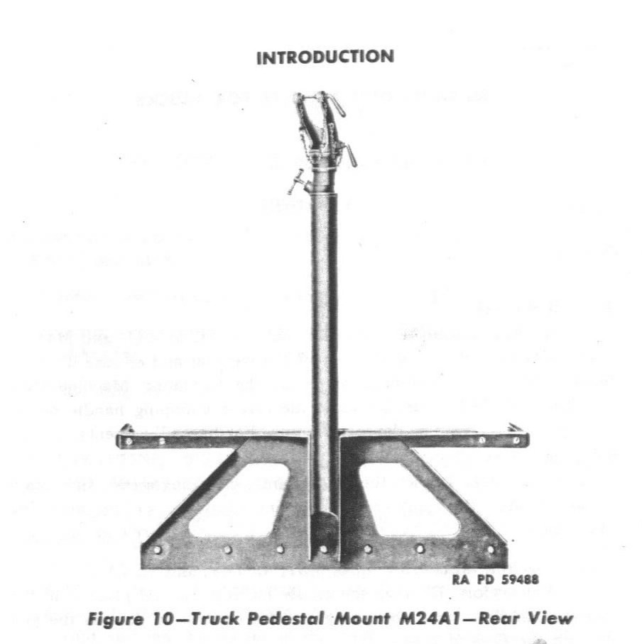

I was just looking at E-greed and saw this http://cgi.ebay.com/WW2-US-MACHINE-GUN- ... 0399124658. It's a PDF copy of TM 9-224 'Machine Gun Mounts for Trucks', dated 1943. My experience with PDF copies of manuals on E-greed is that if someone is selling it then there's about a 95% chance that it's already in the public domain and is freely available on the net somewhere. Most of the PDF sellers seem to be lazy, greedy opportunists that take stuff that's already available for free and just put it on a CD and try to sell them for MORE than what the original manuals sell for! OK so this guy's starting price is only $5 so maybe he's not TOO greedy.
Re: M24A3 Pedalstal mount for the M37...
TM 9-224 1943 is 48 pages. All equipment covered is only current thru 1943.
Page 2 TM 9-224 M24A1 Mount front
M24A1 mount front
Page 10 TM 9-224 M24A1 mount aft
M24A1 Mount aft

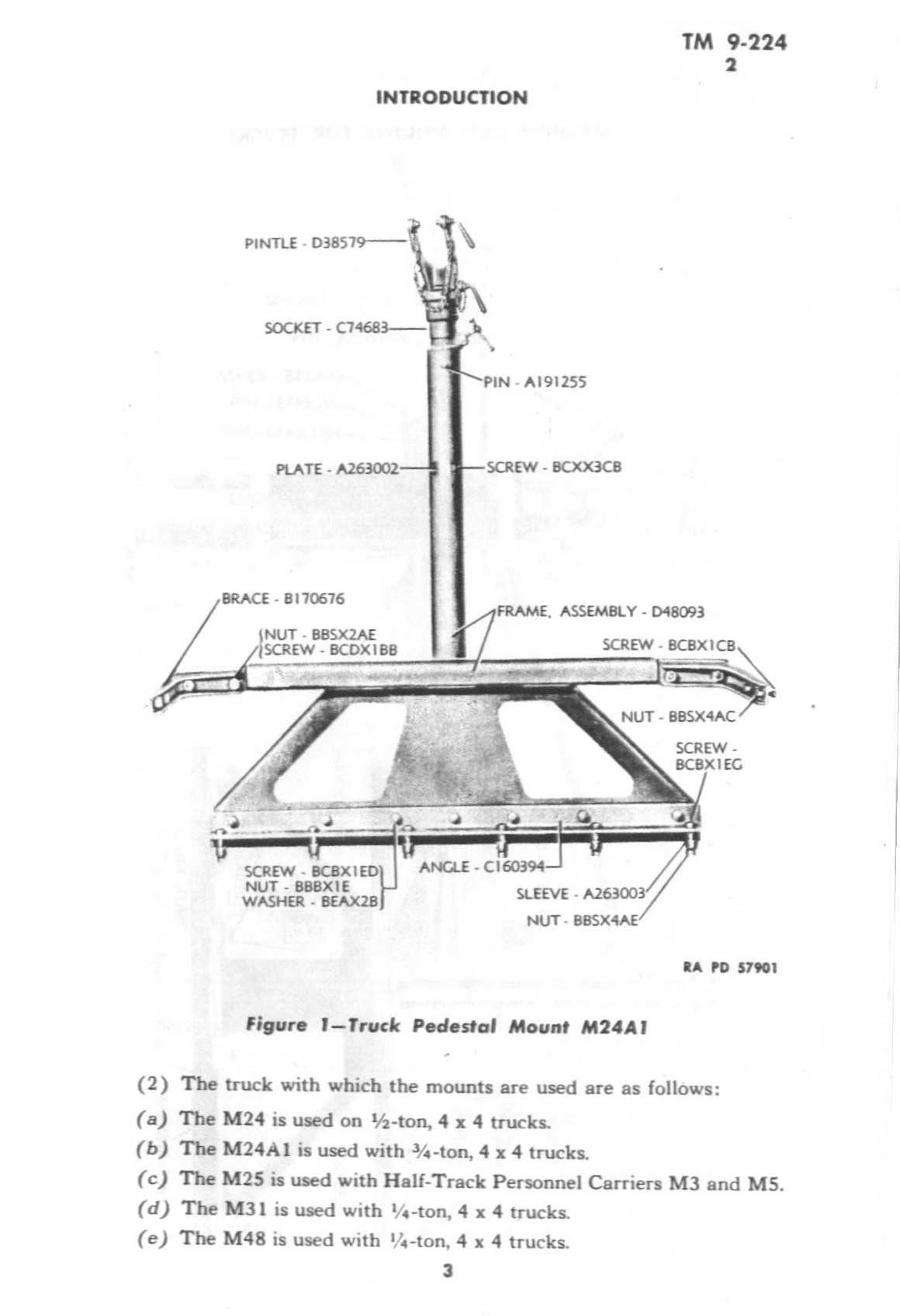

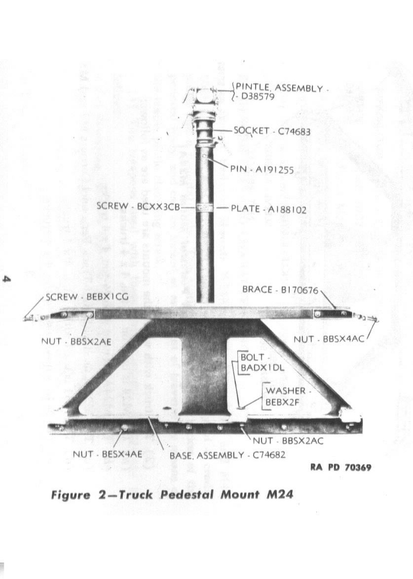

Here's the M24
M24 mount front
M24 mount front
Fig 2.JPG (116.58 KiB) Viewed 2668 times
M24 front
M24 mount aft
M24 mount aft
Fig 10.JPG (62.14 KiB) Viewed 2668 times
M24 aft

Cool anything is better than nothing... I might be able to run across a number that I can pull up a drawing sheet from on any of that info...

Yep that's real close It's got most of the numbers for the parts there... So I might be able to use those to request the blueprints... :)
