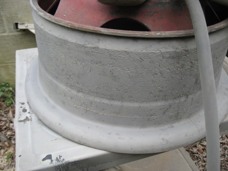

I have a spare rim that I've finally gotten the urge to clean up. I've heard some stories that sandblasting is not a good idea. I've also heard that it won't do any harm. What is the general concensus on this issue?
I have been blasting the rims to get all rust off the rim and out of the deep pitting then welding the worst of the pits, grinding the welds flush and reblasting the area before I apply paint. With no rust left the steel is less likely to re-rust under the paint in a couple of years. The inside of the rim that is out of sight once the tire is mounted is the area that most needs protection and almost never seen unlike the outside surfaces that are easily spot painted once rust becomes visible. The pic below is of a rim blasted to near white and not yet painted. After the shot was taken the exterior was also done, primer and then a top coat applied.

I'm planning to blast my rim tonight if the weather is decent. I took a close look at it last night and its really only the locking ring and the corresponding area on the main rim that need to be blasted. The rest seems pretty clean. Since this is simply for a spare, I'm not going to blast the entire thing. Just want to remove the scale and maybe weld up any deep pits as carter suggests. Then some primer and a halfassed coat of OD and then will reassemble.
