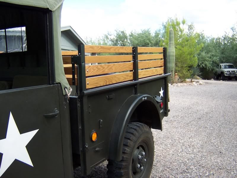

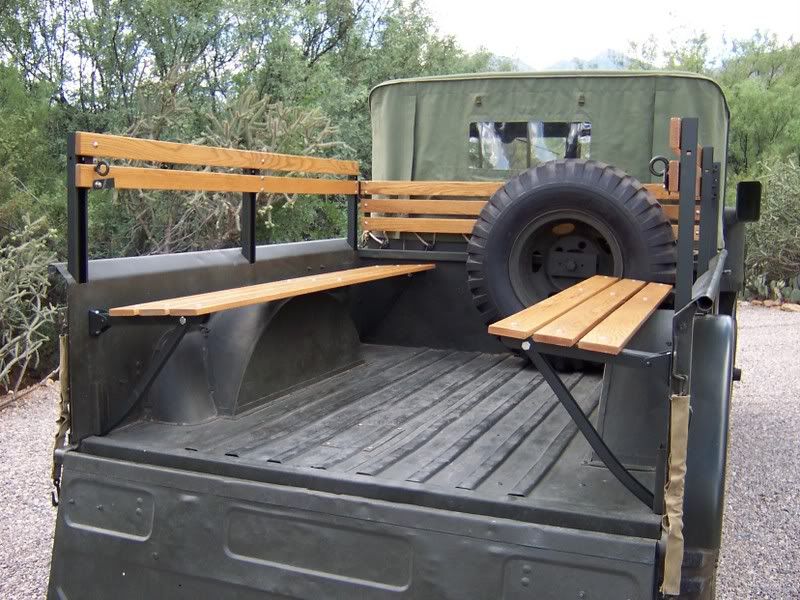

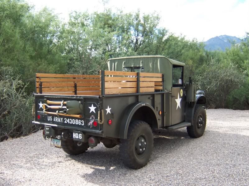

Charles is right on the money with his recommendation for doing the best you can up front. I used Garbees dimensions. The passenger side seat is shorter than the driver side. The upper 2 rails are the same on both sides You can tell right off because of where the seat hinges are mounted. I used oak from the local big box. Cut it to length and rounded the edge of each slat with a 1/8 router bit. I liked the oak so much I stained it and put 2 coats of satin urethane on them. Not MIL SPEC but I liked the look allot. Finally I used stainless steel carriage bolts, nuts and washers for all the wood so no rust and no staining on the wood.
First....Very nice wood on your truck rixm37! Looks Great!
Second, Has anyone ever tried to use fiberglass (PVC) planks from say a HMMWV seats or say M35? I'm just corious as to how well it would work.

BEAUTIFUL pictures rixm37 it is the leanth of your passenger side seats that I'm after hope to come close to your work. thanks one an all. 8)

HI Anthony the seats on the passenger side are 62 inches long. That clears the spare and the tailgate nicely.
Thanks to all of you for all the nice comments :D
