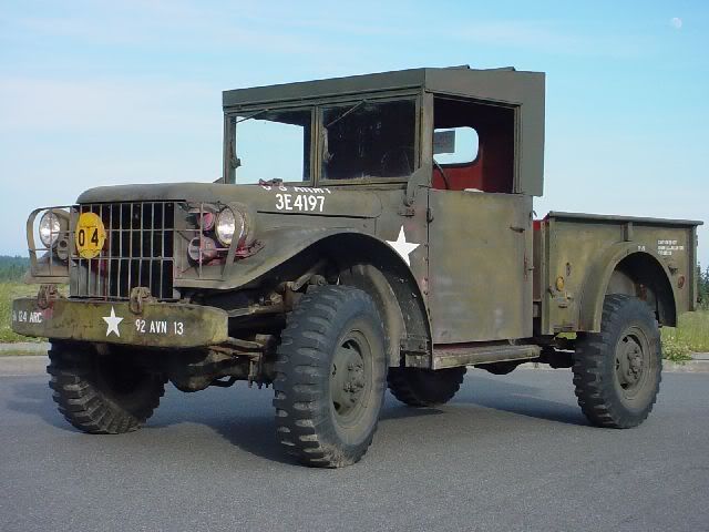

Edit: This is the truck, that hardtop is coming off as soon is I have something else to put on there...
Collin
