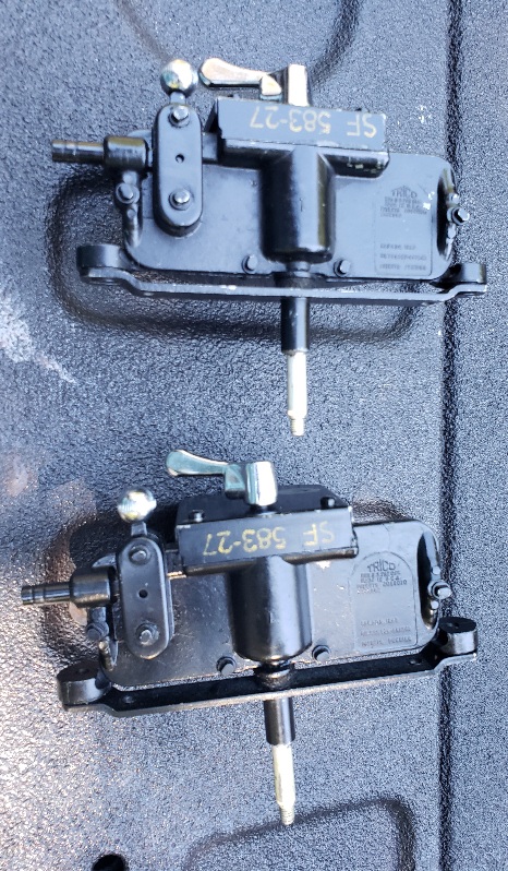

I've been on the fence what to do for quite a while. The Chineseium DC motors are out. Too FUGLY.

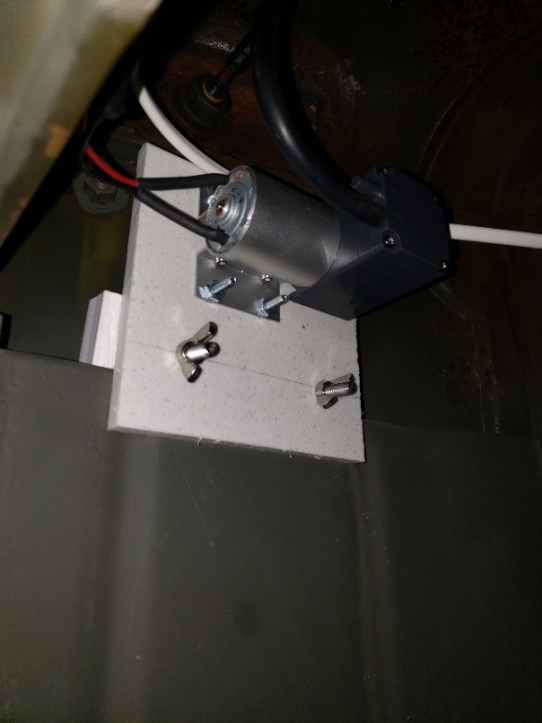

Since the truck isn't "planned" to be run in the rain and I like the look of the originals... I picked up two NOS wiper motors with arms/blades. Going to run them off a 24vdc vacuum pump.

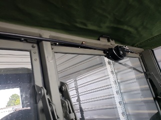

Can anyone post a front on picture of how the wipers sit while 'parked'?
Never mind. I searched the .net and all the original vacuum wipers were parked towards the passenger side.

Done.
The pump is a little noisy but once the engine is going it drowns out everything.(Pump, trains, bombs, volcanoes) :roll:
