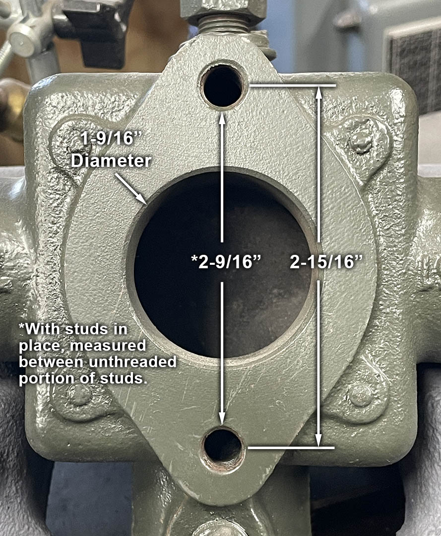

Rdinatal wrote: Thu Jan 16, 2025 11:45 am Can anyone measure, or know, the stud size and distance apart (not center to center) for the carburetor mounting??
You might not need this information if you already have a gasket coming, but here's a photo of the manifold with measurements between the studs as well as center-to-center, which should be quite close. Please double-check them against the gasket you receive in case I made an error.

Thanks for all the input. I picked up a modern single barrel carburetor that "may" work. It's rated for a 220ci to 260ci 6cyl. For $30 I'll take a chance as the jets are available for tuning if required.
Going with the OEM  Federated# F331227H gasket. If I need to open area around the ports there's enough material to do that.
