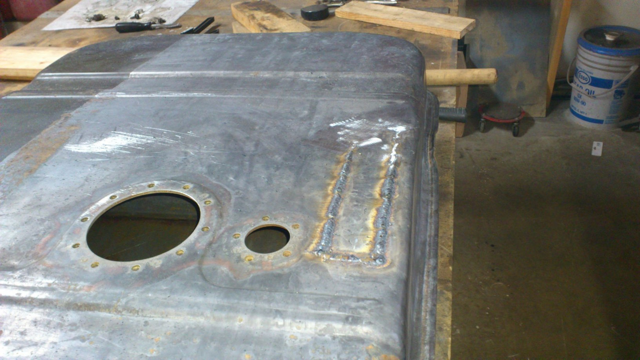

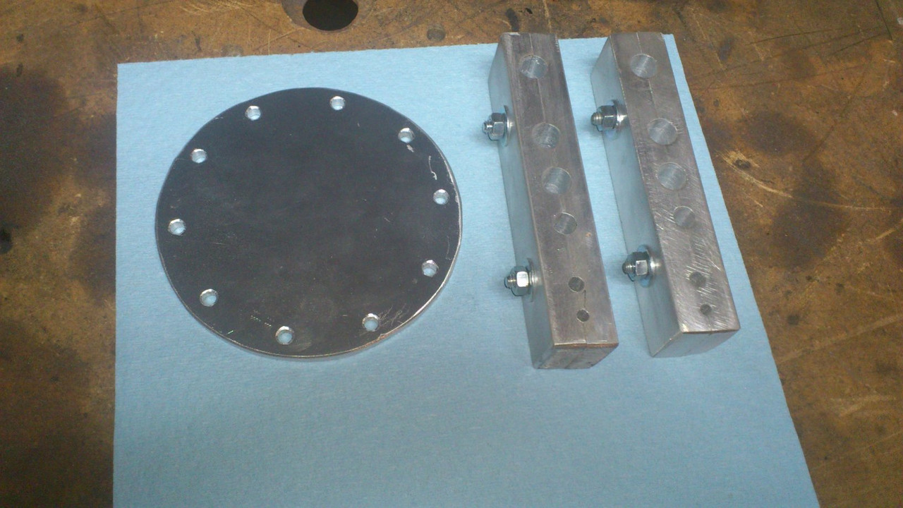

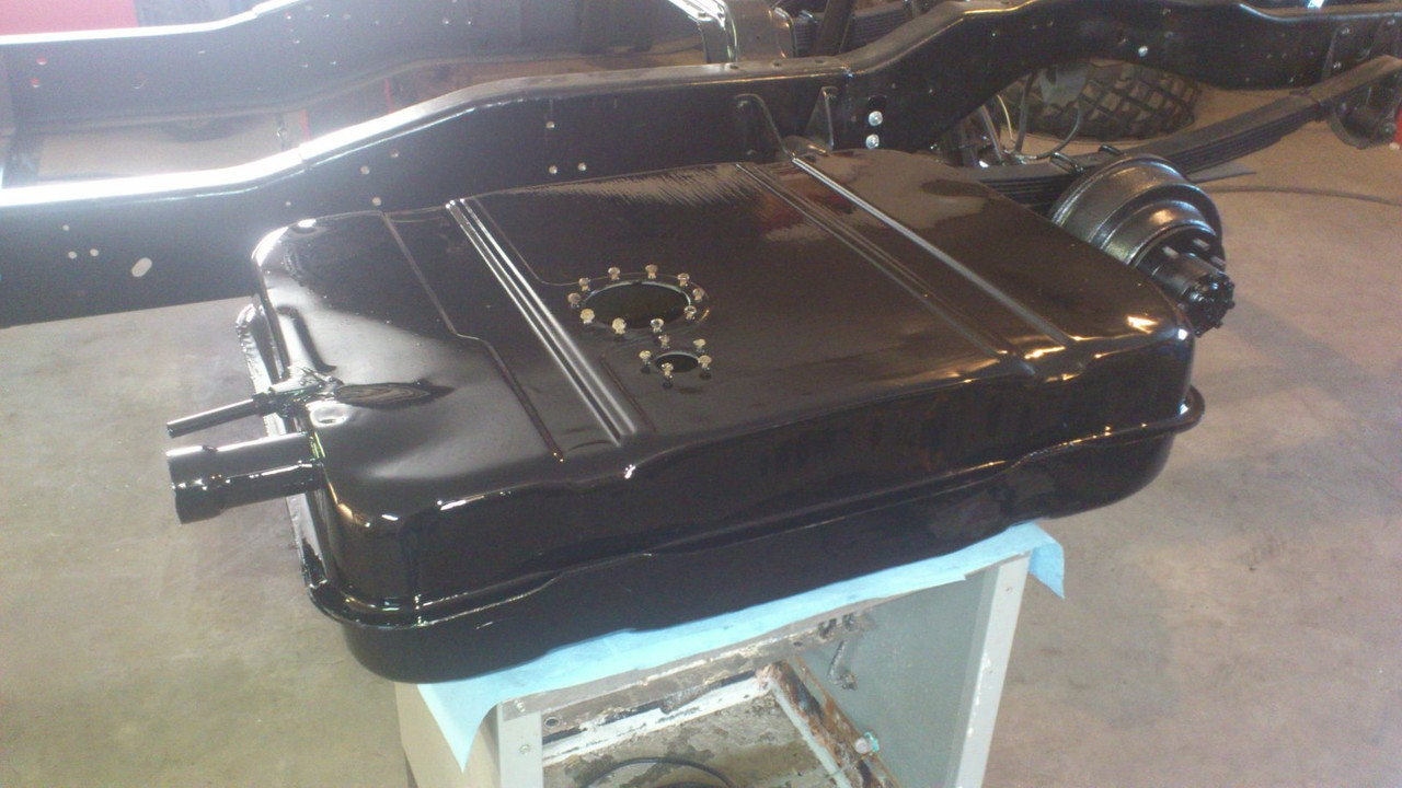

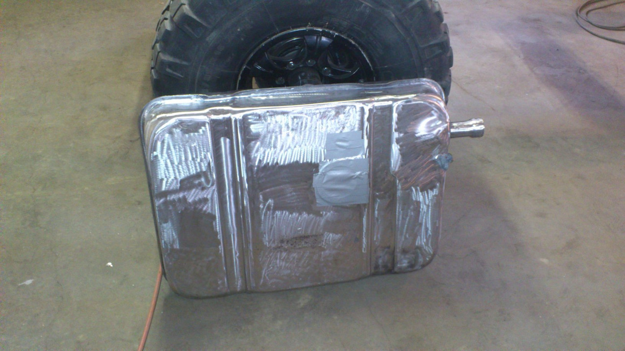

So tank is clean, mostly. There is still dirt stuff in it but I can't get it all out. I'll put in a in line fuel filter before the lift pump to clean up the fuel. The tank had damage on the bottom around the drain so the only way i could pound it out was to cut a hole in the top of the tank and with a round tipped wooden dowl, i pounded it out. then welded the patch back in. Painted and installed the tank. I saw a member build these neat tube holders on here so i was bound an determined to make some too. And a new plate for the draw straw. here is a few more pics.

That tank looks like new again.

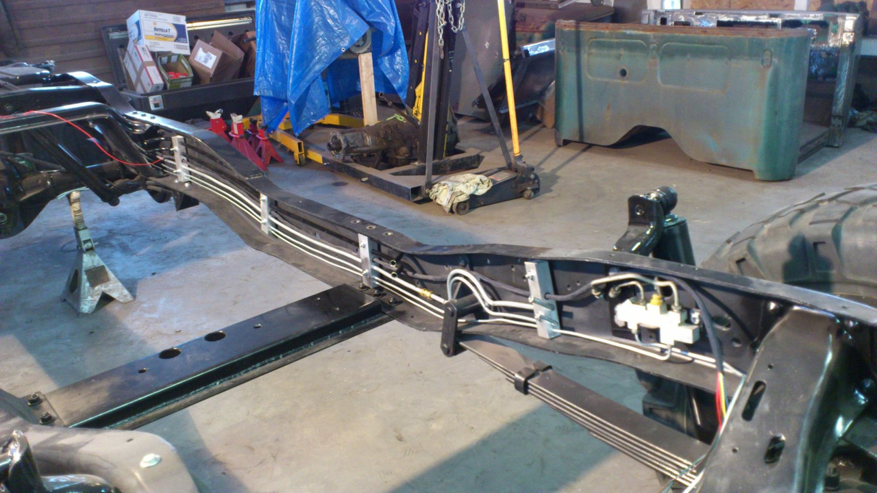

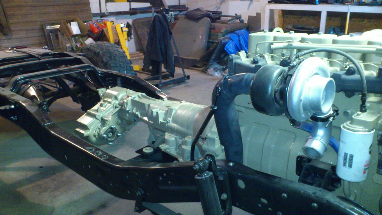

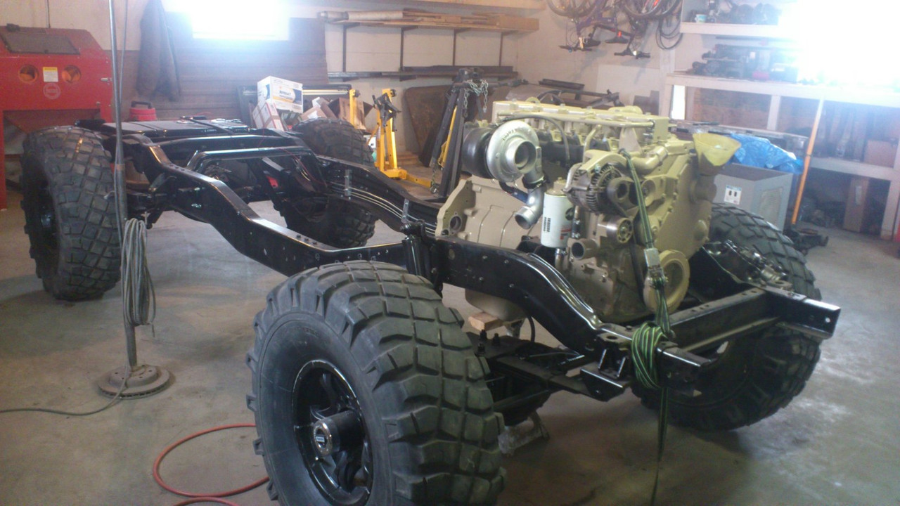

Well I finally finished the line brackets and installed the lines and the rear wiring. Also dropped the engine in. Sending tranny out for refresh tommorrow and getting a new starter and alternator tommorrow. I have ordered the Tranny cooler and the sender and the tach sensor. Cab it going out for sandblast and bodywork and paint shortly.
I believe there was a member that installed a flywheel sensor somewhere in forums, but I just can't find where it was. I someone know please send me a link as to where I can go to see the installation. Now off to reseal the transfer case this week.

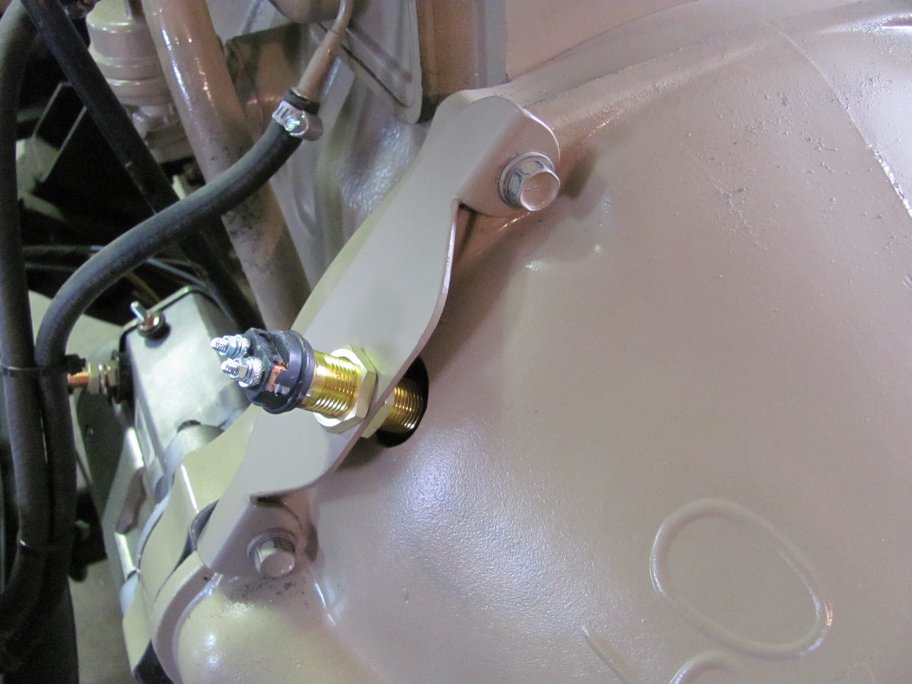

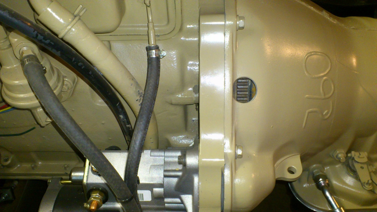

I have a sensor coming from Dakota Didgital. But drilling the hole in the adaptor is out because my adaptor is only 1 1/4" thick the ring gear sticks out of it about 1". Thought about mounting it in the inspection cover underneath but it may get damaged there. Gonna have to do some measuring when tranny comes back from the rebuilders. My son says the gas jobs with multiport have the sensor in the tranny bell housing so I may go and see how it is done there. I will post pics as to I do it.

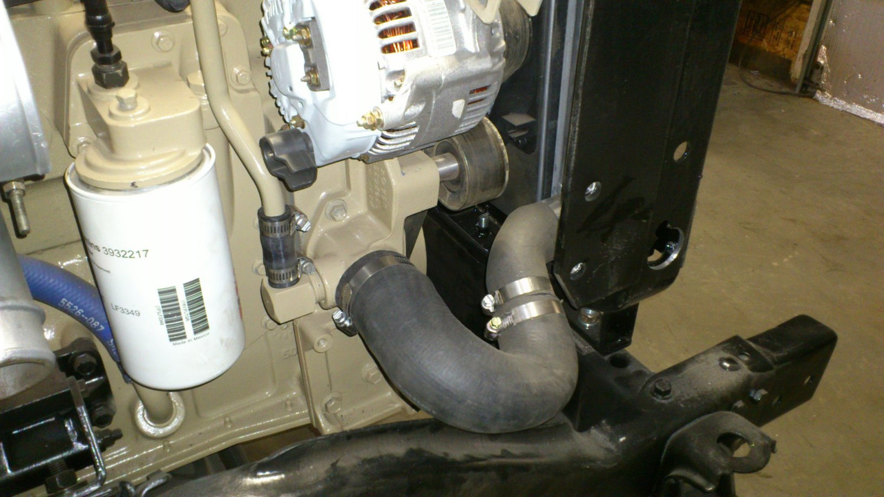

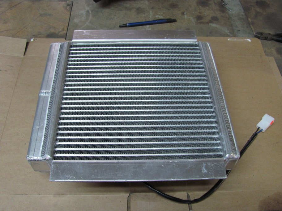

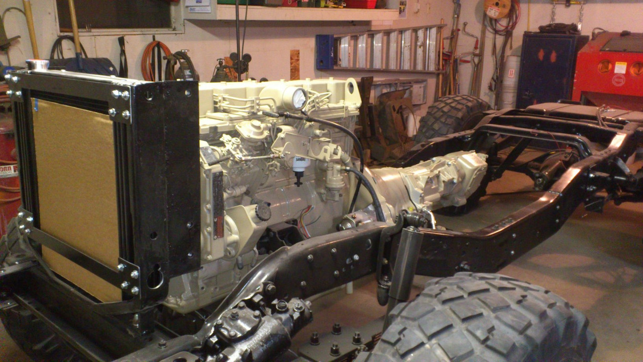

Well I got some more progress pics. Tranny was rebuilt and transfercase checked and resealed. Now installed and starting to hook things up. My tranny cooler should be here from Griffin with the Dakota Didgital sensor this week. I have drilled a hole in the bell housing for the sensor already. I will build a braket off the 2 bell housing bolts to mount the sensor to. The cab is at the paint shop and I will post pics as to it's progress later. I must say that using hockey tape to do the wiring sure makes it look old school. It's way better stuff than traditional electrical tape. Way sticker too. I will post some electrical pics too. All my guages should be here in about 2 weeks so I can start wiring the dash. I am really starting to get pumped now! anyway, the pics......

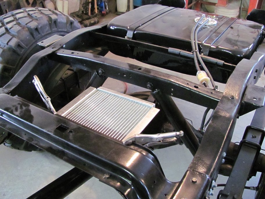

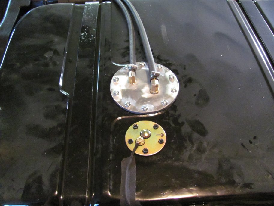

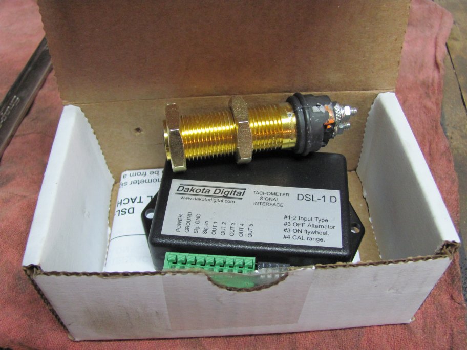

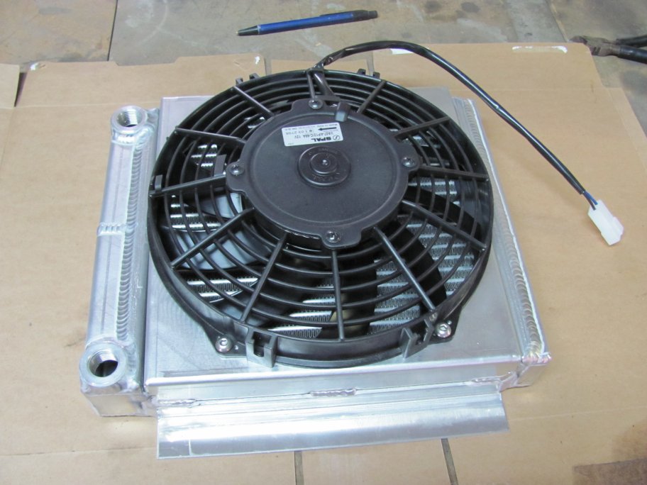

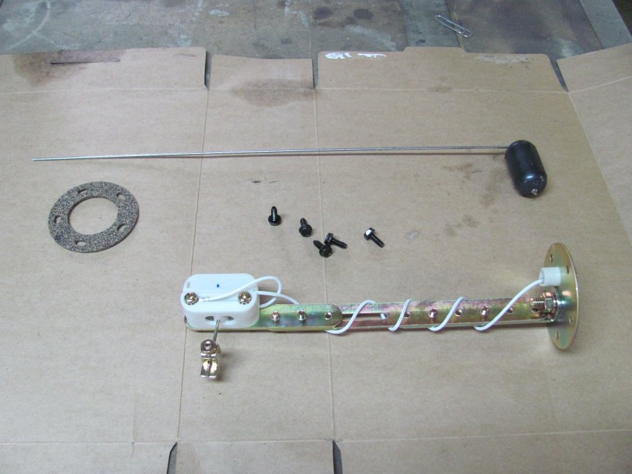

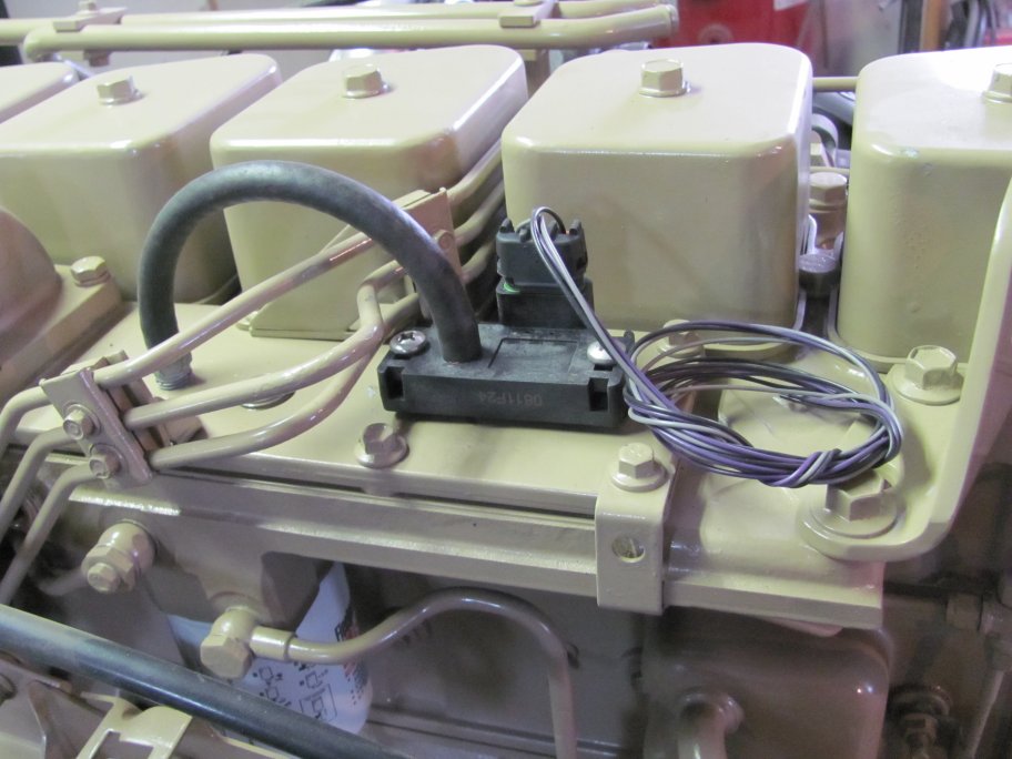

A few more parts go on. Some of wanted to know about the fuel sender from Autometer. Here are the pics. The sender turned out to be the exact size for the tank hole, just the bolt holes did not line up so I made new ones.
This is the kit
Then the flywheel sensor for the tach.

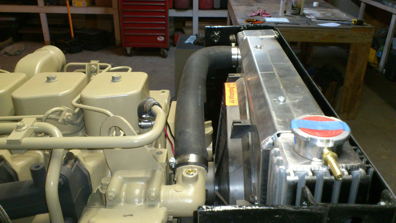

the tranny cooler showed up
This is where I thought of putting it. I read some blogs about guys in Jeeps putting it here so.....
And then the boost sensor

This is the kit
