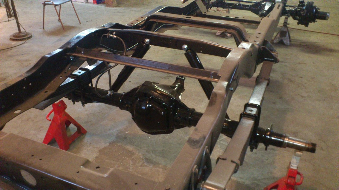

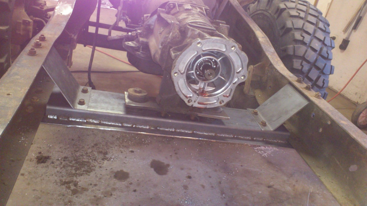

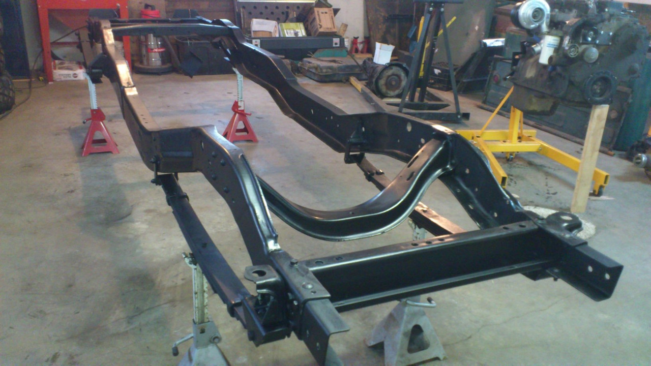

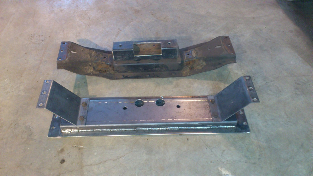

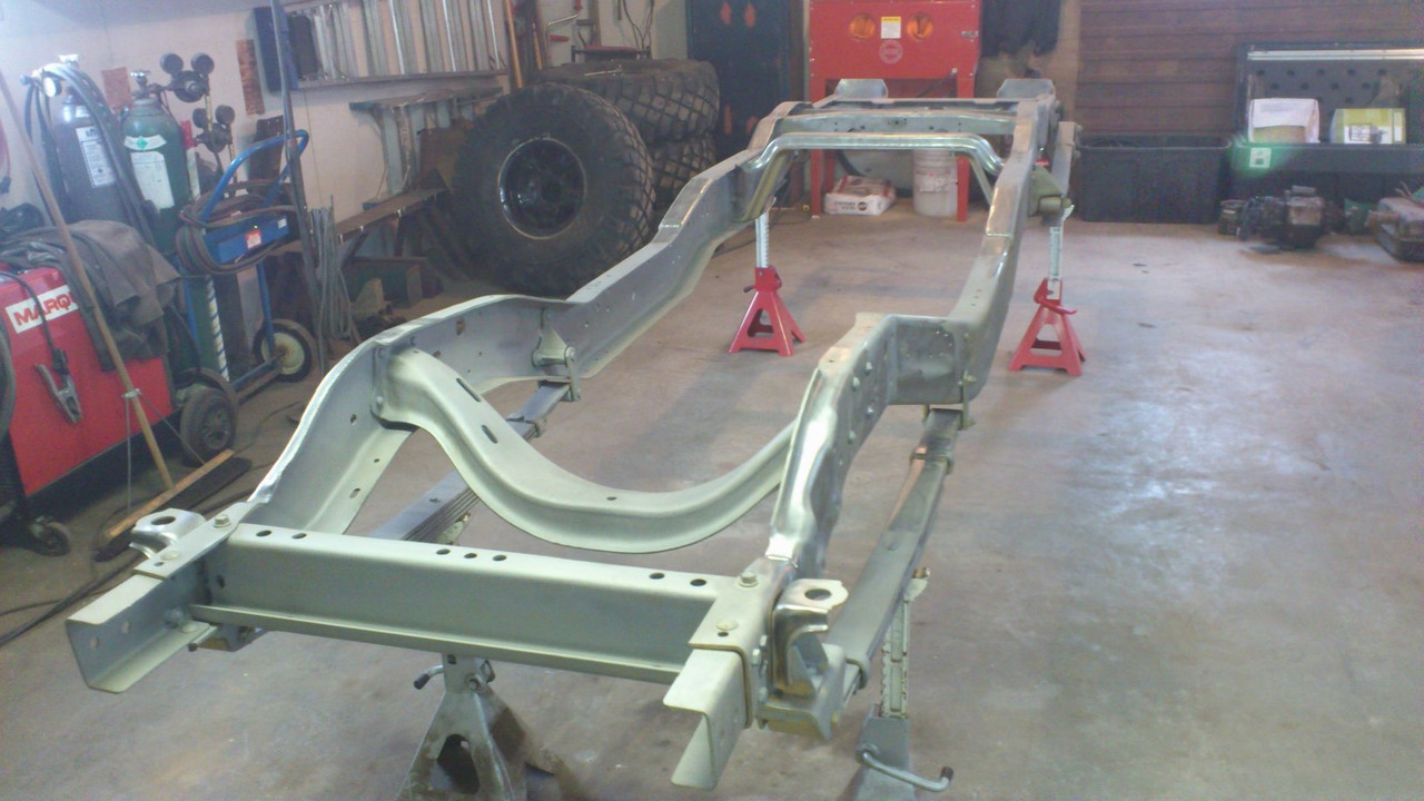

So there is some more progress. All the switches have arrived and all the mounting holes for them are done. I've stipped the trck down to the neccesities and built a new crossmember. The the frame went off to the sandblaster. Here it is back and I hit it with the Por15. Por15 is good stuff but hard to get off your skin!
I didn't like the shape of the old one.
Now off to reseal and detail the cummins.

The frame is looking good, not much arch to those front springs.

You are right, not much arc. I have always known that a leaf that sits flat when loaded will give you the best ride. Unless you go with an aftermarket spring that has less leafs but more arc. I did one earlier, that I put Hi-Jacker suspension in. It had more arc to give me the lift but had less leafs and it rode great. I want to lower this truck as much as possible, because as you see in my previous post, the truck is still plenty high. That is as low as I can go. Cab on it measures 7 ft 4 inches high. my garage has a 7 ft door so I will have to put smaller tires on to get it out.

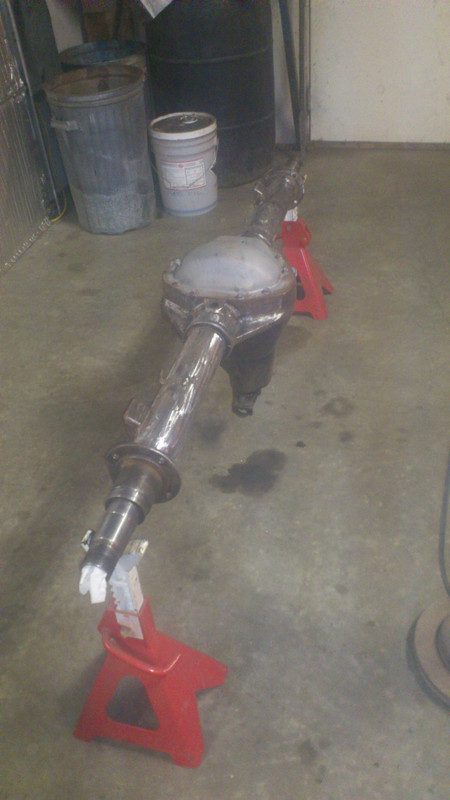

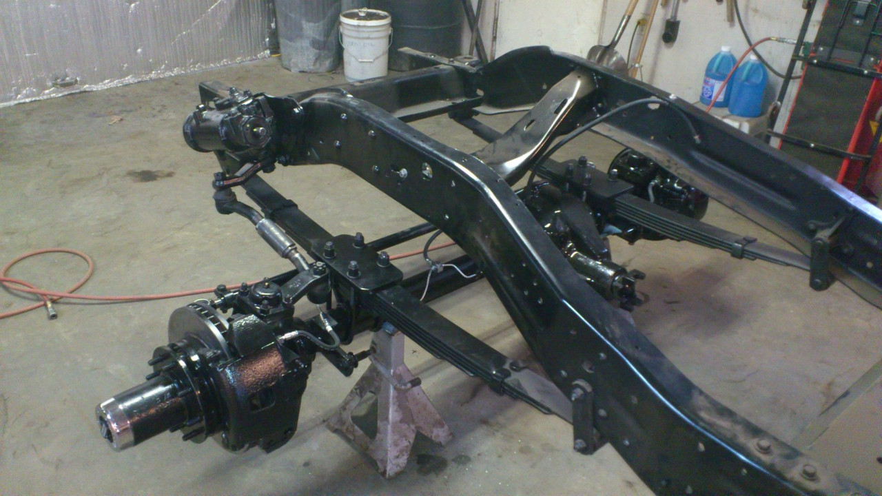

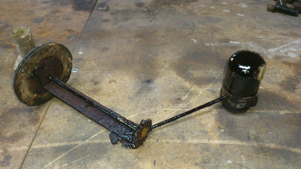

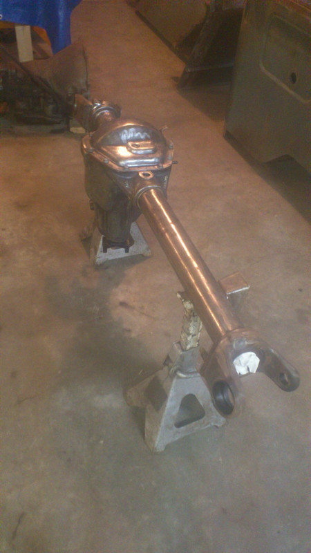

Diffs are finished. the front one was clean and in good condition inside but the steering knuckles out were poor. replaced "king pins", spindle bearings, wheel bearings and seals, pads and calipers, all the hoses and metal lines. The rear diff was run empty and showed signs of metal. So I replaced the C/P and all the bearings. Just have to finish the rear brakes, all new parts again, then on to the fuel lines. Pulled the fuel tank apart and UUGGHH. Black sticky crap everywhere! This is what 40 year old gas looks like?
This tank needs a major cleaning. Then to replace the plate for the fuel tubes and install an aftermarket fuel sender. Napa makes a nice one that is adustable to your tank size and the ohms match the Autometer gage I want to use.

Tell me/us more about your aftermarket fuel sender and your Autometer gauge? Great progress !

here is the link to the Autometer sending unit.
http://www.autometer.com/cat_accessorie ... spx?vid=71
The next link is to the Autometer programable fuel gage. read the PDF installation file and it explains the calibration proceedure. They should work well together as they are in the ohm spec range.
http://www.autometer.com/cat_gaugedetai ... 699&sid=60
This will work with many different senders too.
The Napa one is similar and retails for about 47.00.
This temp gage interests me too. I think this one is for me.
http://www.autometer.com/cat_gaugedetai ... 872&sid=60
I like the fact it can turn on cooling fans.
Same goes for the tranny gage!!

Shes looking good. I didnt know the 80's trucks still had kingpin 60's, I thought Dodge had gone to those miserable ball joints by then.
