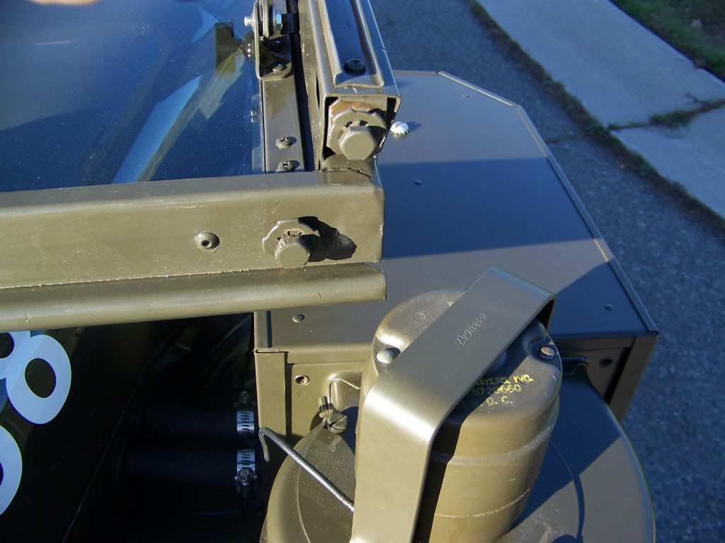

Found that the w/s contacts the support bracket so we had to switch it around to miss the corner of the w/s.

Thanks for the feedback - would anyone have a picture of their motor cover ideas? While we want to stay original, the truck is going to be driven so we'd want to see about protecting the motor. Keith

We fab our covers from a length of exhaust pipe tubing of the correct diameter with a plate welded into the top end of it, light weight yet rigid enough to do the job well.
