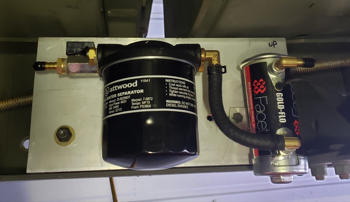

With the right electric fuel pump, there is no need for a separate pressure regulator. I used this Facet 24V Pump rated at 4-5 PSI mounted on the frame back near the fuel tank. I've got over 7000 miles on it with no problems so far.

In my 19 year adventure with My M37 I have only been stranded twice. Each time it was a mechanical fuel pump issue. With the OEM pump the lever pin backed out. Then I put a civvy PW pump on. That lever came apart. Two years ago I installed a Carter 24VDC marine grade pump with a spin on fuel filter at the tank and it has been great. Oil pressure activated. A little buzzing noise but glad I did it. I put electric wipers on years back so no need for vacuum.
