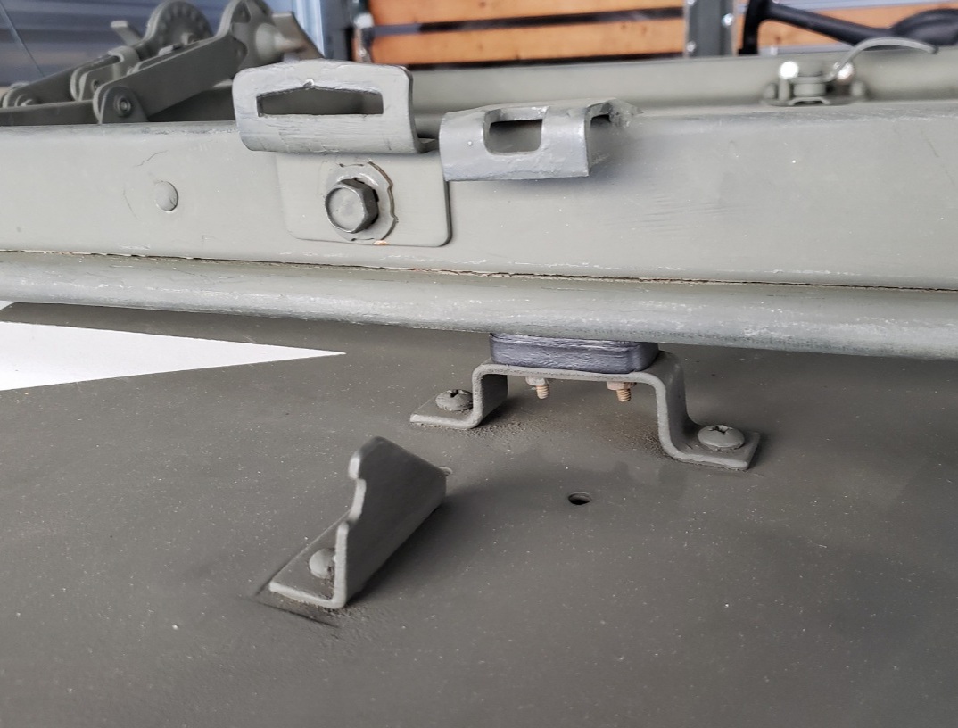

In preparation for transport this week I decided to fold the windshield down to cut air resistance while trailering. There seems to be missing some type of locking mechanism when it's laying on the hood. No strap loops, nothing.
Am I missing some hardware??

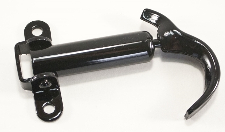

You’re missing the hold down latches. They look like the hold down latches for the hood but with a different handle. Midwest Military has them im sure.

Thanks for the description. I was able to find them. Ordered!
Hood to Windshield Catch 7005413
