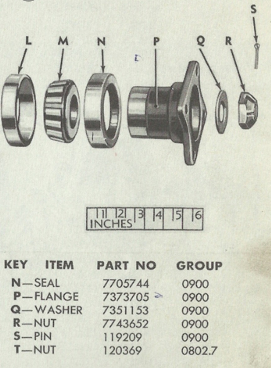

Redi Sleeve?? I'm not familiar with those. Its not on the IPB below. Please explain more on this.
Guess I'll have to see the condition of the output flange.

The sleeve is an aftermarket device, made of really thin steel and designed to slip over the damaged flange area and be seated with a drive collar and hammer. Simple to do.
The part of it that the collar rides on is then removed, leaving a new, smooth surface for proper sealing.
Some are also known by 'SpeedySleeve'. Google is your friend.
