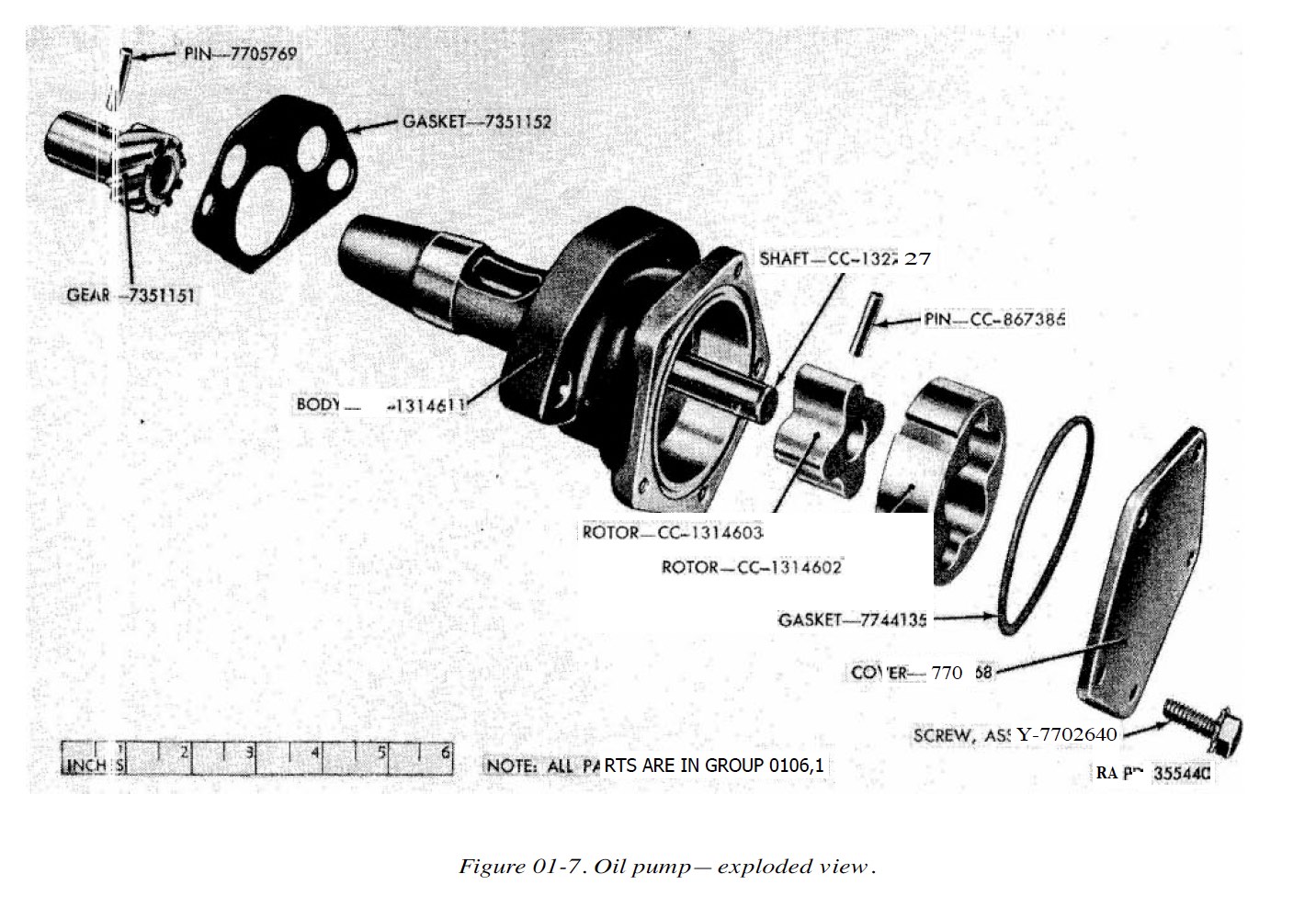

Yes, you can remove just the cover, and replace the O-ring gasket.
Screenshot 2023-05-07 at 8.44.35 AM.jpg (253.65 KiB) Viewed 6758 times
Just be careful not to let the outside rotor fall out of the pump when the cover is removed, and replace the cover with the same side towards the pump internals.
As I recall (been awhile since I had an oil pump apart), the O-ring might be a square section ring. I don't remember the dash number off hand (and am away from my workshop today) but it's available from McMaster-Carr. Midwest Military also lists them as a separate item in their M37 engine section online.
Be sure to clean the inside face of the cover, the mating face of the pump body, and the O-ring groove in the pump body before reassembly.
