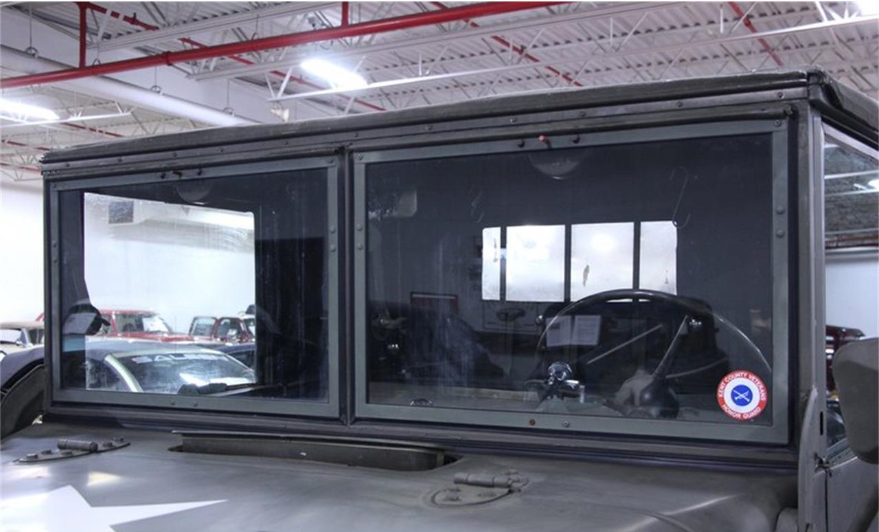

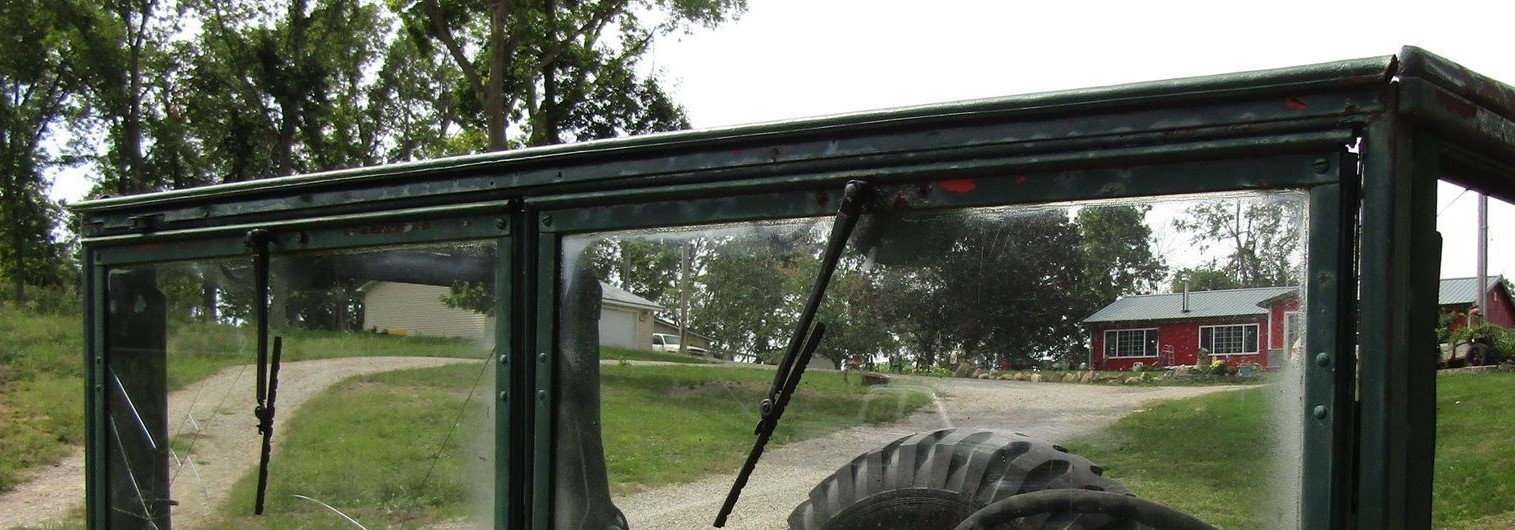

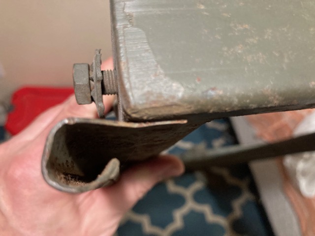

Some update....., I have seen pictures of windshields that have the metal lip screwed. But also others where the piece is welded.
Anyways, as Hal mentioned, perhaps this can be something to procure. I will ask suppliers about it and let's see.
Screwed.
Screwed.
Welded.
Welded.

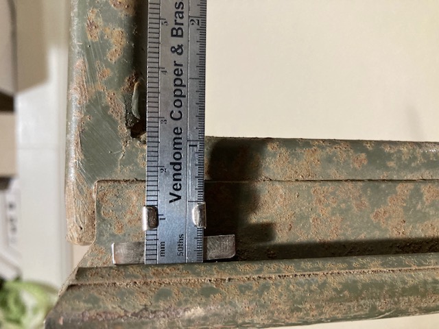

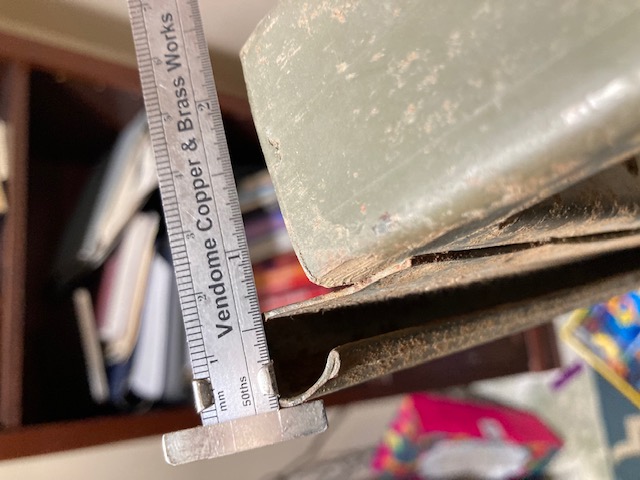

This is off of a NOS window frame that has never been installed.

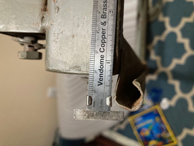

another pic

Oh, this is great. Many thanks, Max. :D
This helps a LOT!
I've done a few calls here in Europe and nobody sells the part (one person offered an entire windshield,..."no thanks").
So yesterday in the afternoon I asked the guys at the shop to check for the scrap deposit in order to see if the part was still there and check the possibility to cut & save that thin metallic lip. This for sure will give us the idea to mimic it in case is not feasible (I do think we will fabricate it, is was completely welded to the roof).
