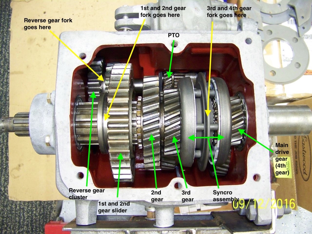

Here's a photo of my NP420 with the top cover removed. Reverse gear is at the upper left, the smallish gears sort of hiding in the bottom of the case. First and second gear is engaged by sliding the large spur (straight cut) gear on the left (to the left for 1st, to the right for 2nd), and 3rd and fourth are engaged by pushing the center disc of the synchronizer to the left (3rd) or right (4th, which is actually just direct drive).
NP420 trans.jpg (238.96 KiB) Viewed 2395 times
That large straight cut spur gear is why these transmissions make so much noise in reverse and in first gear. And the synchro on 3rd and 4th only is why engaging 2nd gear can be a bit tricky sometimes.
I believe that all of the gears as shown in the photo are in neutral. The reverse gear must be pushed to the back of the reverse gear shaft (all the way to the left in the photo). The large spur gear is definitely not in second (if it were, the small pointed dogs between the 1st spur gear and 2nd gear would not be visible). I think it's not engaged in first gear, but I can't see the countershaft to be certain. Anyway, it's very close to neutral. The 3rd/4th gear synchro is in the middle, so neither 3rd nor 4th is engaged.
To verify that all of the gears are disengaged, i.e. all are in neutral, leave the clutch released (this connects the input shaft of the transmission to the engine, and prevents the input shaft from turning). Then try to rotate the output shaft flange (you mentioned that your transfer case is not connected to the trans, right?) If the flange can be turned by hand, everything is in neutral. If not, one or more of the gear sets (each speed is a pair of permanently meshed gears, one on the mainshaft, the other on the countershaft) is engaged. Try centering the synchro disc and the large spur gear, and verify that the reverse gear cluster is all the way to the back, until the output shaft flange can be turned by hand.

That did it! Thank you for the visual aid. It's been fixed and now I'm ready to add oil and reconnect everything.
