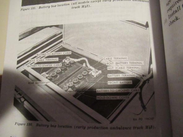

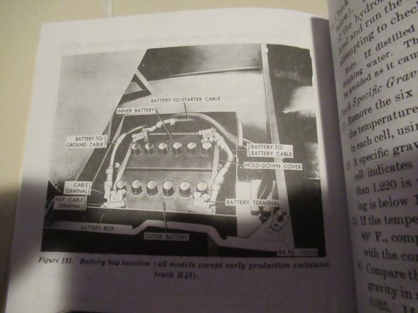

Re: M37 Battery's
From my TM9-8030 manual:
M37 batteries 2.JPG (36.06 KiB) Viewed 3281 times
M37 batteries 1.JPG (35.75 KiB) Viewed 3281 times

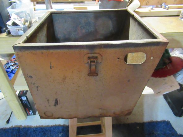

Re: M37 Battery's
Your battery box is missing. Bubba likely tossed it due to a rusted out bottom.
Here's what should be there:
box 5.JPG (37.97 KiB) Viewed 3243 times
slk
Posts: 83
Joined: Sat Jul 10, 2010 4:13 pm
Re: M37 Battery's
Post by slk »
So do they bolt in or just sit in? Are they made to take in and out with the batterys in them. Will have to see if I can find one.

sturmtyger380
Posts: 581
Location: Up State SC
Re: M37 Battery's
Post by sturmtyger380 »
Down in the bottom of the box is a tray the batteries fit in. It is bolted to the bottom of the battery box and the floor. The long bolts for holding the batteries down fit in holes in the tray. You have seen the top hold down.
My tray was rusted and corroded with no long bolts. My batteries were held in place with pieces of 2X6 shoved in beside the batteries.
Years ago I was able to find a good tray still with the long bolts. I had to weld in patches to the battery box bottom and some of the cab floor under the box. No batteries yet but soon. I am building the engine the last big item.
