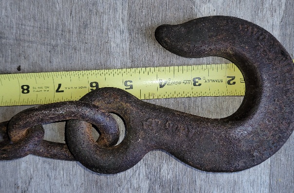

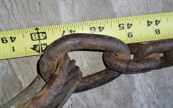

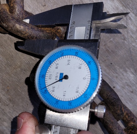

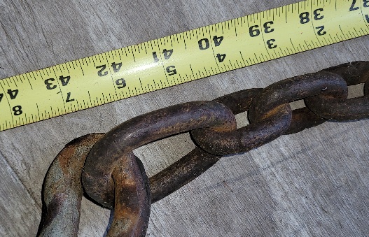

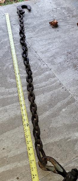

Neat. Here's what I came up with. Ignore my cool orange shoes and all the cat hair. :oops:
Overall Chain length (excluding the large links that connect to the hook and the wire connection): 40.5"
Each link is roughly 10.5mm thick, 34mm wide, and 50mm long

So, that comes out to 4 feet long not the 5 feet that I have always heard.
