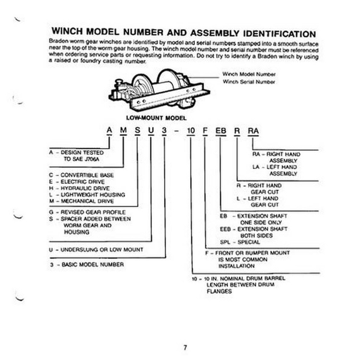

Just found this and did a quick search in case it was already posted. Seems not, otherwise admin or moderator can delete it.
Braden winch model ID

Those were used on the WW2 militaries, and civvy Power Wagons.
The G741 trucks (M37, M42, eTc) all used the LU-4 winch.
