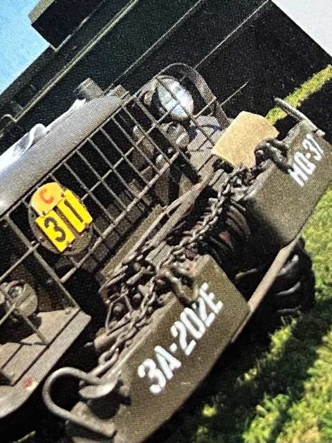

Here's the photo I found in the MVPA magazine. I'm thinking the support was to keep the bumper from folding up when using the "paper clips".
This photo looks like what sturmtyger380 described. I was wondering if anyone knows any details. It looks like there may be something the top of the winch too.

The two cross pieces on top of the winch help hold the two ends on. Here is how mine looks now.

That's identical to mine now. I was curious about any reinforcements added to prevent the "smile". Thanks for the link, I've studied your rebuild :). The plan is to have the winch disassembled tomorrow to see what it needs. Fingers crossed.
