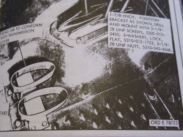

New member with a new to me '54 M37. I bought a project that someone started and lost interest. It's about 70% done, so I'm hopeful I can take some time off from work and finish it over the next month. I'll start with the most important question: It has the vertical M1 gun holder on the passenger side of the dash, but the floor was replaced so I'm not sure of the exact location to dill and bolt the butt holder (which I found in a box of parts!)? Any guidance or a picture that you can offer?

- m37 lower gun rack mount.JPG (52.33 KiB) Viewed 4038 times

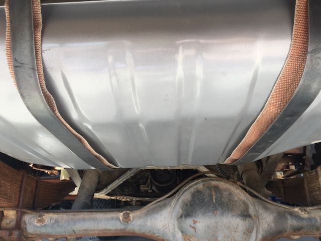

Here is a shot of a new S10 gas tank in the M37. The S10 is a 20 gallon tank, where the factory M37 was about 25 gallons. When I purchased my M37, it had a tiny 12 gallon tank in the truck. That was rusty and had to go. Did not stomach a $700 bill for a newish M37 tank. The S10 was $100, delivered.Cal_Gary wrote:Welcome Brett and thanks for saving another M37!

Re: Guns & Gas Tanks
What a clean install, looks like it belongs there.
Lookin' great!

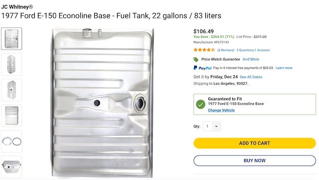

There is a Ford Econoline van tank that fits even better and is 23 or 24 gallons. You will need to google it. It is also a sub $100 item.
Interesting. I'm not finding an Econoline tank that is 23 or 24 gallons, however. (Though I'll admit searching for car parts is not something I'm good at.)just me wrote:There is a Ford Econoline van tank that fits even better and is 23 or 24 gallons. You will need to google it. It is also a sub $100 item.
outpostm37
- CPL
- Posts: 128
This is what I found for the Ford Econoline gas tank.
- Image 12-22-21 at 7.11 AM.jpeg (30.71 KiB) Viewed 3692 times
OK. I found the link based on the image posted by outpostM37.
https://www.carparts.com/details/Ford/E ... 70143.html
Is that the one known to fit?
