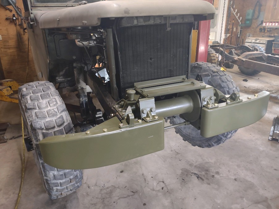

When you go to put the PTO winch on, you can convert your original bumper to the winch bumpers. I had a local fab shop do mine, since his welding comes out MUCH better than mine. To get the radius on the inboard edges of the bumpers, he split a pipe of the appropriate diameter lengthwise and welded that onto the bumper.
Winch-Bumperettes mounted sm.jpeg (135.58 KiB) Viewed 1547 times

Did you have a drawing to work off of or just measurements from the truck? They look great and that's the route I'm going to take since they keep the original bumpers with the hen's teeth.
Posts: 436
Re: Truck update and doing work
Tim Holloway of Distinctive Restoration took dimensions from the bumpers on his M37 truck with winch. The fabricator got his sketch along with a sample winch bumper from a Power Wagon (different overall dimensions, but it had a similar radius on the left side edge for him to compare)

That would be appreciated. It would give me something to go by at least.

Send me your address and I will mail you what I have.
Tim
