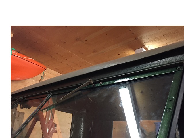

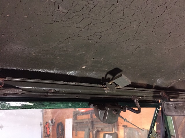

Here is how my hardtop is attached at the front. This is as it came from the military.
- 0E2D2807-8A1A-48FB-82B4-19040DA6F2EF.jpeg (95.18 KiB) Viewed 1599 times
- 36808478-F02E-4517-BAB6-1D71D688C8C5.jpeg (65.13 KiB) Viewed 1599 times
