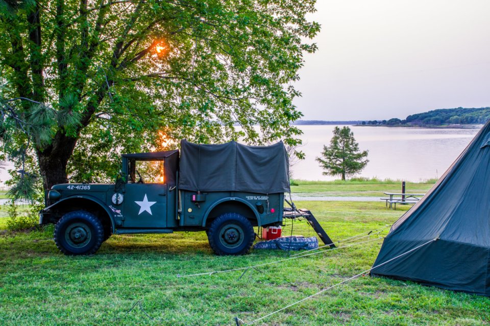

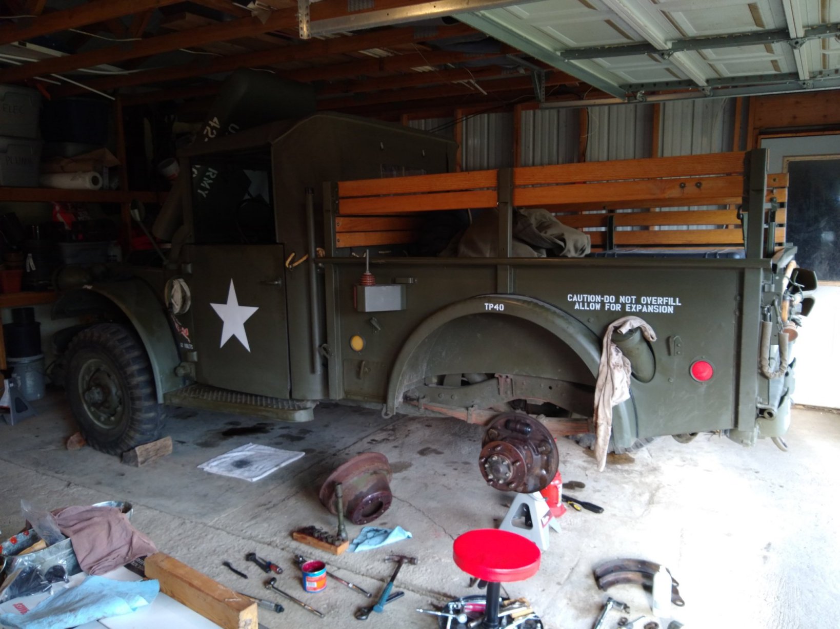

For pictures:
In the field:
Working on the brakes:
I got this M37 since it seemed a lot more fun than a quad bike or SxS rec vehicle, and it is, I am having a blast with it. I will mostly do Amateur Radio "Parks on the air" with it, but it seems people like these in shows and such as well.
