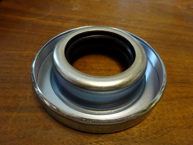

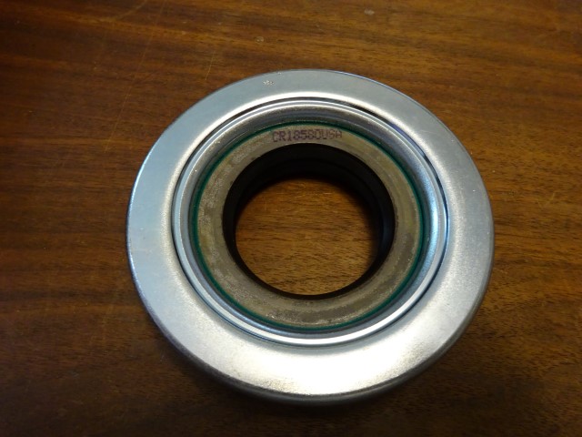

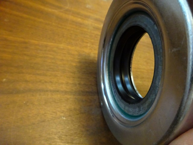

What seals did you use? Did you use a ready sleeve(if necessary)? There are basicly two things that lend to leaks, bad sealing surface on the yoke, or bad seal- you should be using new design seals, not the old leather ones.
- DSC00887 (Small).JPG (105.18 KiB) Viewed 2198 times
Re: Leaking differential seals
What Bob says. I just went through this with the rear differential on my truck. A new neoprene seal with a sleeve on the yoke fixed it right up.
There is also information on this site about using the outer shell from the leather seal, and replacing the inner portion with a modern viton seal. While this should in theory work, I couldn’t get it to seal properly and went with a new rubber style seal instead.

Thanks gentlemen, as always I appreciate the wisdom...
So, considering that Fiona sat for almost twenty years, I guess I should replace the seals! Duh!! They weren't leaking prior to the servicing, but that could be because the fluid was a gel... LOL!! Thanks for the photos for the new seals I need to purchase.
