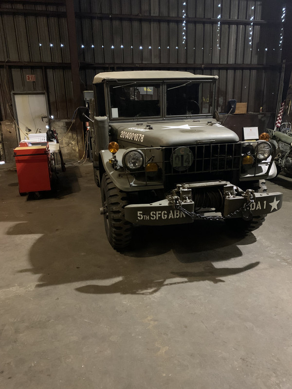

By the way, now having my truck under cover in a hanger at the nearby airfield, along with about a dozen others, with all sorts of tools and machinery, my truck sits and starts like a champ. I am out there all the time, with friends, and have set up my own work bench and restored the surplus tool chest. I have just about all my truck tools and parts there now, because my truck is done, and needs nothing. CT put my engine back together and I have NO leaks. Soon another parade to roll out for.
Prime my fuel pump system, a little choke, and hit the starter, and within a few revolutions of my engine, it coughs and hacks and then settles into a nice even idle. I run it to warm up and nove it a bit to lubee the gears and such and rotate the tires at least weekly. Next to some surplus Marine recon motorcycles from the Government Surplus center next to us.
Here, my truck sits all content and safe a few yards from the club where the Doolittle Raiders met to be selected for their historic 1942 mission. We are negotiating for a recovered B25 flown by them in training, which crashed in a nearby big lake for our Doolittle Museum. More about that later.
