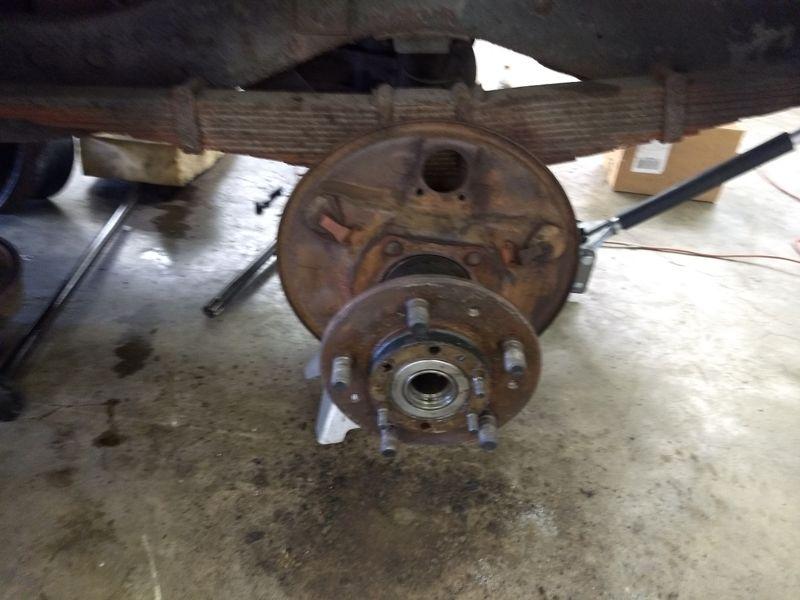

Although this is my first work on a M43, I have rebuilt rear axles on various Jeeps, a 44 Chevy 1.5 ton, M8 Greyhound and M2A1 halftrack. The TM says this is supposed to be a full float axle with wheel nut. Look at the pic and this one has no wheel nut. It appears to be a semi float with a pressed bearing. I was surprised as all the other military trucks and tracks I have worked on were full float. As it turns ok I will probably let it be.

You need to pull off the seal plate with your fingers. The bearing retaining nut is under it.

It is a full floating axle. Your photo shows the axle seal, and as stated above once removed will reveal the bearing retainer nuts.
