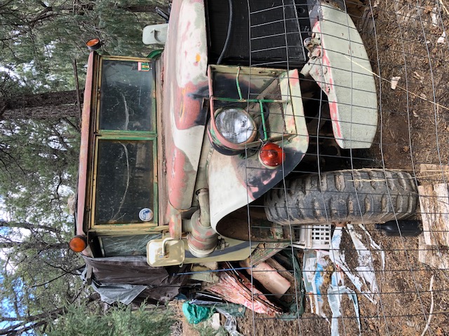

This is my first time on the forum and hello to you all. My wife and I just picked up an 1953 M37 project vehicle and it has inside it 6 cylinder inline diesel marked 510E-6050-FL which appears to be a tractor engine (6D Mark 2) modified for driving British delivery trucks??? Does anyone know anything about these? As in is it worth keeping the engine, power etc.?

while I have no information on your particular re-power engine, I would suggest it is runs, to keep it and just drive it. Converting back to a standard engine would be too much effort to to be worth it. Of course, perhaps someone else will be along and state that your power plant is original to your truck. We would love to see some pictures of where you are starting from.

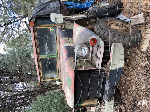

It is rough and vehicle has been parked since 2002 (but all ran then). Formerly a vehicle for ranger outreach center and their state department etc. trainings. My wife and FIL just finished a body off frame FJ40 rebuild and old Bronco rebuild so this is their next project.
Like I said, rough, but I think super cool.
