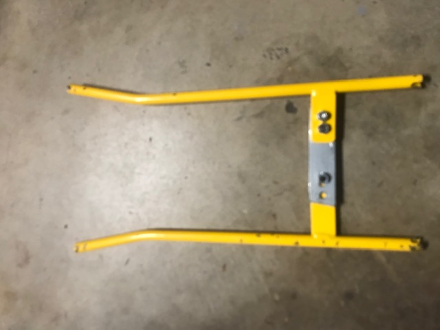

Thanks, that's exactly how I was taught by my father. I'm working on modifying the spring plier I bought, but at the end of the day I may just need a bigger set of vice grips and hammer! LOL!

Good News... Brake springs are installed. My modification to the tool worked well! Yea!!
