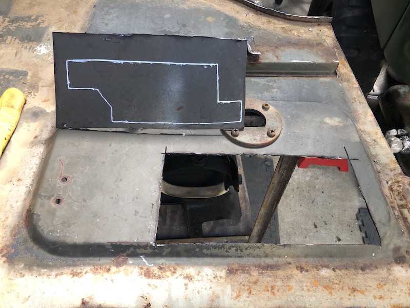

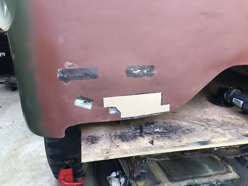

A few more pictures of the finished patch.
Tony

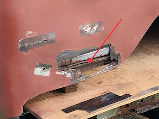

I haven't welded the patch yet because I want to apply some type of rust control treatment to this area and other hard to reach areas. See attached picture.
I've been reading about POR-15 but I don't have any experience with the product. Its it good? Do you guys have any recommendation of any product that you have used before? Thanks!

I believe first you have "neutralize" rust, then prevent it from coming back. POR and the like have to be properly applied or rust will continue under ir. I think the best site for information and products is KBS, at:
https://www.kbs-coatings.com
Once rust is neutralized, then it can be coated with a product, then painted, and finally, if an interior panel, perhaps some sort of "wax" or the like sprayed on ir. Ir is important to use the right primer before any "paint" is applied, too. There are products that seep into metal seams to seal from water and oxygen, too. Lots of products for each stage. I would buy from the same company, so their products are fully compatible.
So in summary, the steps are:
remove as much rust as possible.
neutralize, prep, prime, paint, and perhaps seal.
Good luck, NV

Looking at that photo, I can tell you there is rust all along that seam. I would cut out much more than that.
Get as much of the loose rust off or out that you can. Buy some Phosphor Prep and Etch from Home Depot and paint it on keeping it wet for a number of hours. Don’t let it get on your shop floor as it eats concrete.
Rinse it off with water or acetone. Then you can weld in your patch panels.

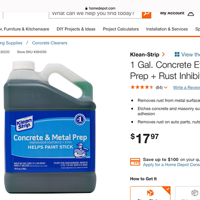

Thanks for that info. Is this the product that you are referring to? Can you spray it or brush only?sturmtyger380 wrote:Looking at that photo, I can tell you there is rust all along that seam. I would cut out much more than that.

Yes that's the stuff! I use a cheap brush and get the rusty metal wet and keep it wet like trying to soak it. Watch out and don't get it on your skin or concrete floor it will start eating the concrete.Is this the product that you are referring to? Can you spray it or brush only?
Once I feel like the metal has been treated enough I use acetone to rinse it and stop the etching process. If I am not going to weld the metal I make sure it has a good coating of Rustoleum rusty metal primer.

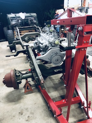

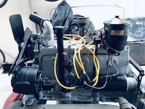

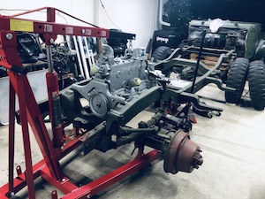

As promised, a few pictures of the progress. It's been so long since I resized and uploaded pictures, that I forgot how to do it. But I figured it out. The engine is installed.
- IMG_8888.JPG (59.97 KiB) Viewed 1907 times
- IMG_8886.JPG (39.31 KiB) Viewed 1907 times

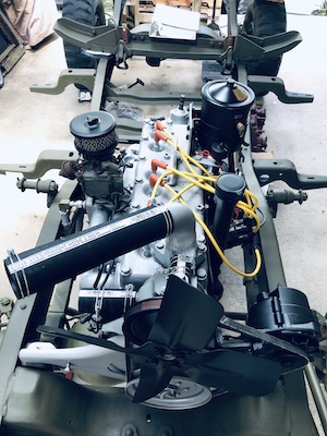

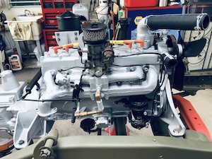

Little by little, putting it all together. It's about 95% completed.
