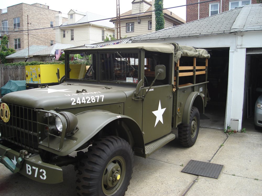

Here's my 53 painted Cat yellow and black. I have much more money in 2k primer/sealer than in paint.
I did this 20 years ago and it held up very well, it gets lot's of attention where ever we go.

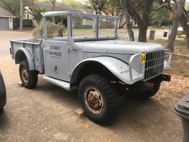

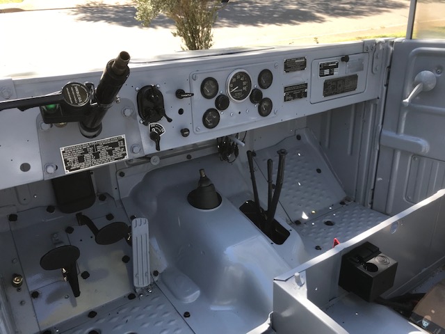

I used MESA GRAY in an acrylic enamel. My decision was based on the color I wanted and price. Hope this helps you make your decision.
Dennis
Investig8
1953 M-37
1952 M-38
