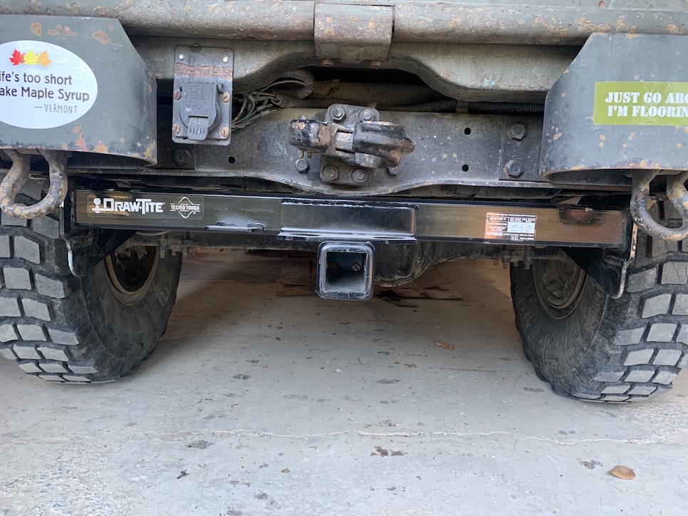

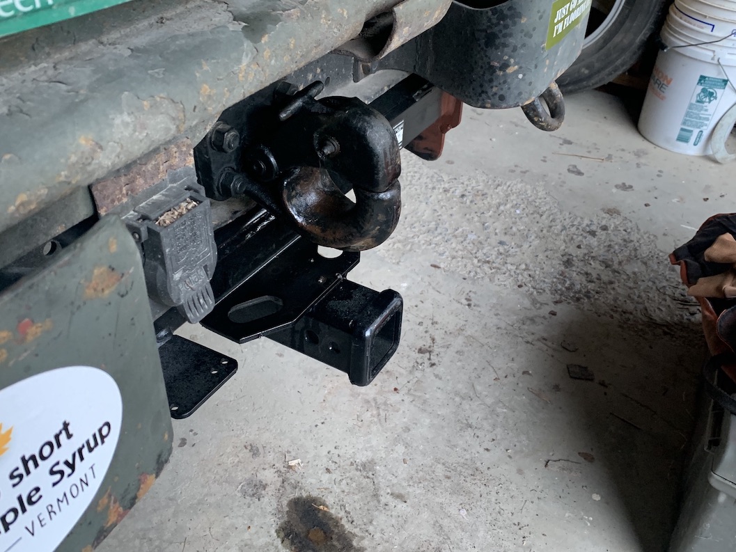

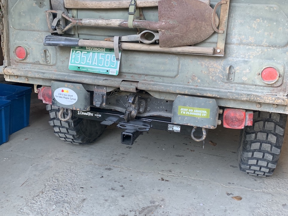

I ordered a Draw-Tite 41536 receiver (it fits a 2001 Dodge Ram Truck, and I had heard that other hitches for this truck will bolt right on to an M37 just by drilling a few holes). It's rated for 6000# GTW / 600# TW (10,000#/1000" if used with a weight distribution hitch).

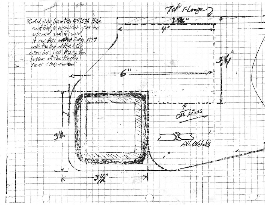

I brought the hitch to a local fabricator who did a bit of cutting and welding to move the cross bar forward about 2.5" and up about 2.5" to 3". He was careful to maintain the center-to center spacing between the left and right mounting holes on the hitch flanges. The rivets mounting the truck's rear cross member to the truck frame were drilled out. The hole was used for the rear-most mounting hole in the receiver hitch.
Here is what I ended up with:

See drawing the fabricator made up of how he modified the hitch. Basically, he cut out the cross tube, leaving a bit of the sides connected to it as a square flange. Then cut out a similar square in the desired location and welded it back in.
I would suggest verifying the dimensions before actually cutting and welding, but it should be close as shown.
