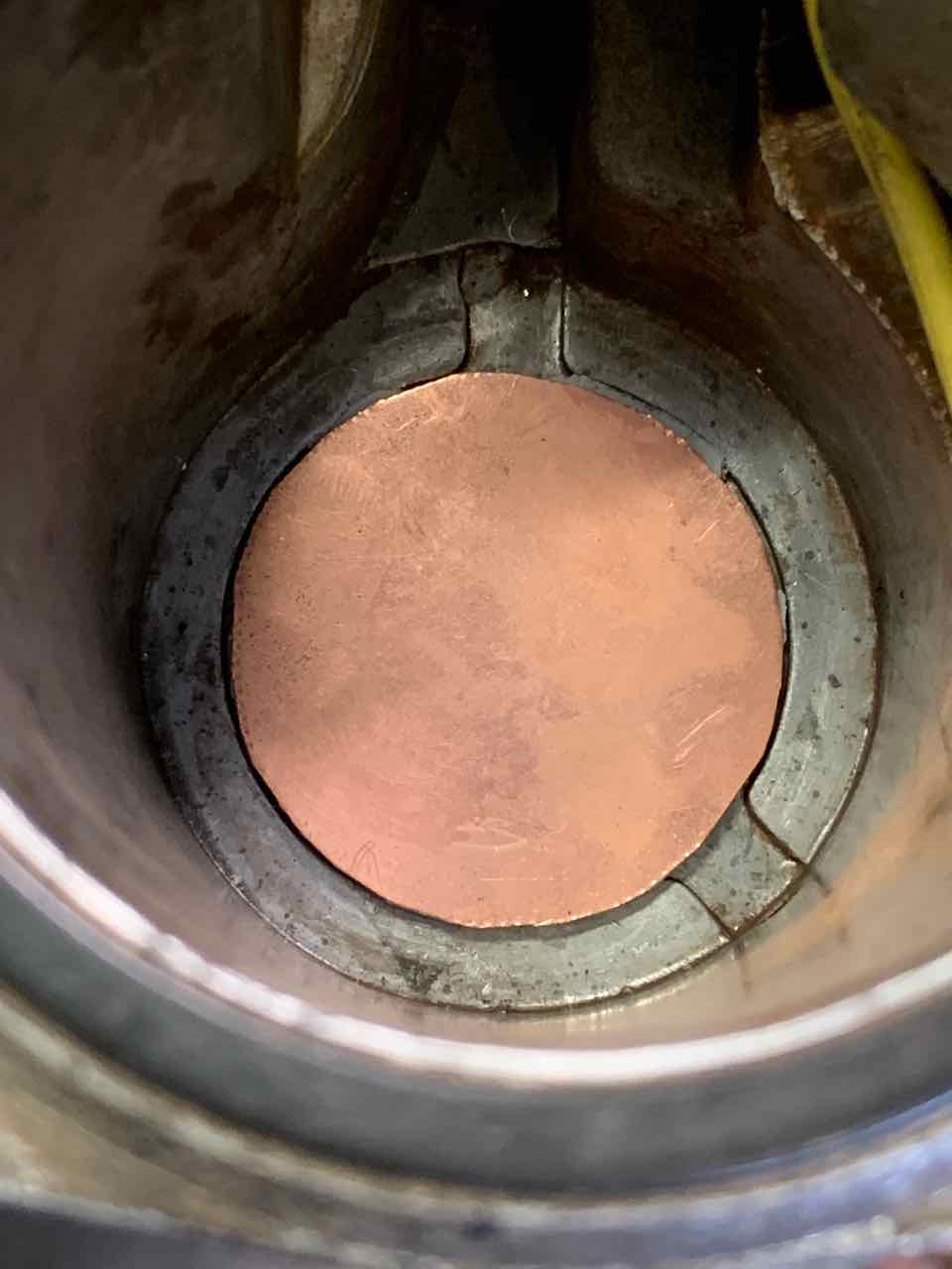

I use a .025" thick round section of copper shim to fit into the recess in the distributor where the coil sits. Coat both sides of the copper with thermal compound (grease). Install the import (Chinese or other) coil and secure with the two screws. This will aid in the transfer of heat from the coil to the outer body of the distributor.
See photo.
copper in M37 distributor at coil.jpg (57.02 KiB) Viewed 954 times

outpostm37 wrote:I use a .025" thick round section of copper shim to fit into the recess in the distributor where the coil sits. Coat both sides of the copper with thermal compound (grease). Install the import (Chinese or other) coil and secure with the two screws. This will aid in the transfer of heat from the coil to the outer body of the distributor.
See photo.
I'm told that part of the need for this washer is that the import coils are not as long as the original, so do not make good contact to carry the heat away. The shim helps take up the gap. (I've not seen one myself, so just passing along what I have read.)
