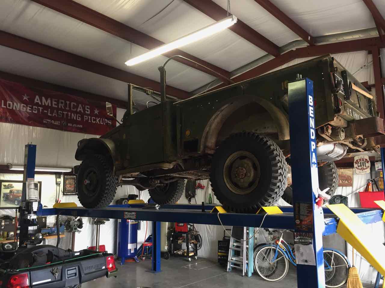

I bought the 4 post Bendpak 9000lb lift. These lifts have the option of castors so you can lift/lower a vehicle on the lift, disconnect the power and air supply, and move the vehicle on the lift, push it sideways or wherever in the garage. Also you can put a vehicle on the lift, raise the vehicle, and park an additional vehicle underneath. Each lift type has its limitations. The two post must be bolted to the ground and arms that position to the lift points of the vehicle. The four post lifts are more secure with the weight, the vehicle driving up onto the rails. Your call on what you want.
M37 on lift in garage.jpg (116.05 KiB) Viewed 1757 times
