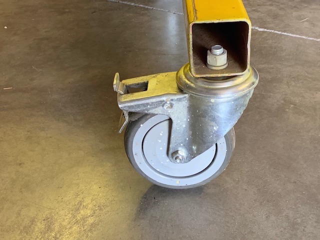

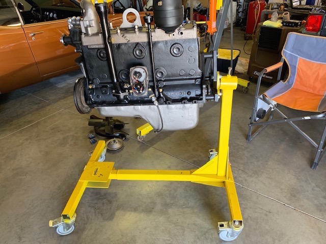

Here is an old Lakewood engine stand that I converted to 4 wheels. The 3 legs and tiny steel wheels would catch in any cement crack. Dumped an engine block over one time. No more. Made this one longer to accommodate inline 6 cylinder engines. put large wheels on it too. All wheels have a lock.

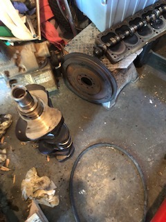

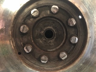

Well, then, I have a story to tell. When the truck was owned by the City of Hampton Roads, they put a clutch in. When they installed the clutch, they put the disc in backwards, so that the shoulder was rubbing on said bolts. I had been driving the truck for about a year, and had no problems.
While at the Georgia rally, I was way back in the woods screwing around, and attempted a hill climb one time too many- I had made it up and down the hill twice, so three shouldn't be a problem, right? Well half way up, the clutch failed-big time. After a 3 mile walk, I came back with my buddy's M931a2, and towed the M37 back to the campground. Tried to adjust the clutch, but no go. Got on the phone to Vintage Powerwagon, and had the whole mess Next Day Aired to me in the woods.
Did a field change out, and discovered what had been done. The bolts(which I thought were studs), are so badly chewed up that they don't look like bolts. I basically buttoned it all back up(with the the clutch disc in correctly) and went on my merry way. 3 years later, and I am freshening up the motor( everything is looking good coming out) I now find out that they are bolts. I will try and upload photos of the flywheel, but I can be computer stupid sometimes.
So where can I find flywheel bolts?

So basically the heads are ground off of the flywheel bolts and there is really nothing holding the flywheel on but the remnants on the bolts without the heads? Damn! You might want to order up a new flywheel while you are at it because I will bet those bolt holes are going to be oblong. Hopefully the holes in the crank aren't wallowed from not having and torque on the flywheel bolts and then the rotation pushing them side to side.

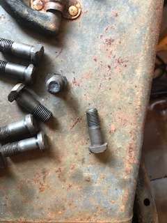

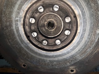

I got lucky. Finally removed the crank from the block, and removed the bolts off the back of the flywheel. Everything came out fine, and the bolts look to be okay- the clutch disc didn't do much damage to the bolts.

Flywheel bolts

Hell, you can use them over again!
