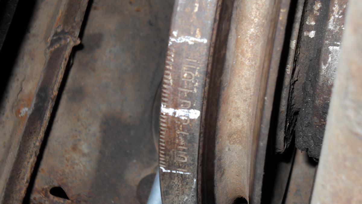

Re: one of my original questions regarding timing marks. Attached is a picture that I got off the internet. Looks like it has TDC marked. In this picture would BTDC be below or above this mark?
- Timing Marks.jpg (119.01 KiB) Viewed 1269 times

That is not the timing marks I have on my pulley. one way to be sure you are are looking at where before TDC is, and sitting here now a thousand miles from my own truck, is to put the gearbox in neutral, and grasp the fan blades and slowly pull the the blades around in the direction they world properly pull air thru the radiator.
Then, as the timing marks, (I think there is ten little marks on each side of the TDC mark), when the marks first start to approach the timing mark pointer tip, that is advance. As the marks move past the tip of the pointer, to the middle, then to the last marks, that is delayed or retarded timing. Be sure your engine is at idle, about 500 rpm or so, as the centrifugal weights in the distributor will start to give advance at much over that. If you set your timing at say 800 rpm, it will be delayed, which can cause high cylinder heat.
