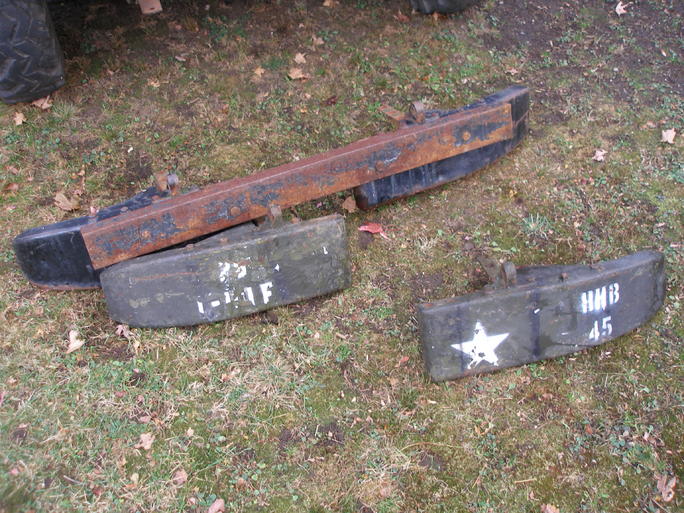

I found this picture of my original bumpers. I can't really read the left side but I can use the info on this page to figure out as much as I can. Good info thanks. I do know my truck is an M42 command truck so that could help I guess, HHB goes along with that.
