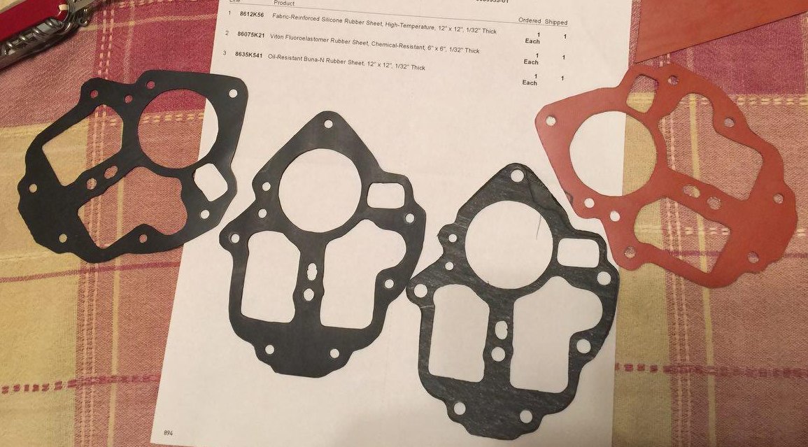

Carburetor Rebuild Question
I've resolved my fuel leaking problem...MSeriesRebuild was correct...the two halves were not flat. After surfacing them, and replacing the paper gasket with a Viton Flouroelastomer gasket...no leaks. I do have a question after my "pump up leak test" (no leaks):

- Making a better carburetor gasket
- photo_2018-01-29_09-33-07.jpg (160.55 KiB) Viewed 4443 times

Did you make those gaskets? If so, how'd you cut them out?keyslammer wrote:I've resolved my fuel leaking problem...MSeriesRebuild was correct...the two halves were not flat. After surfacing them, and replacing the paper gasket with a Viton Flouroelastomer gasket...no leaks. I do have a question after my "pump up leak test" (no leaks):

Thanks
